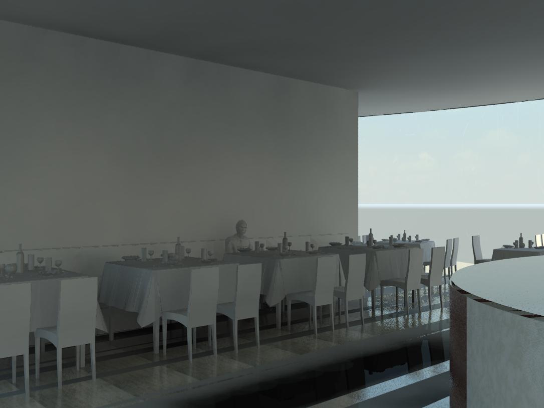

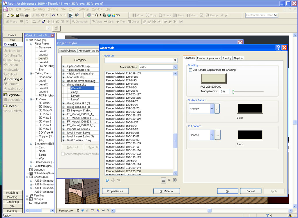

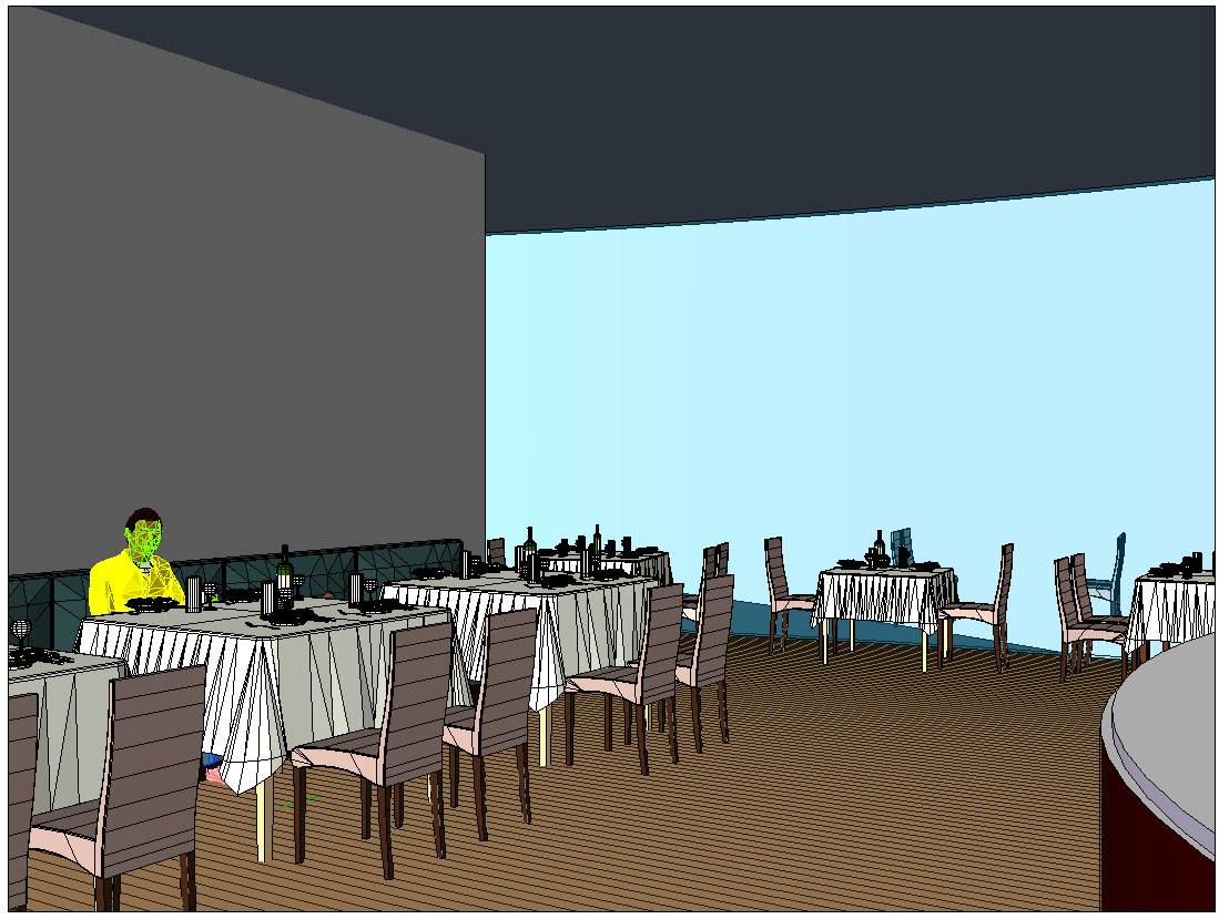

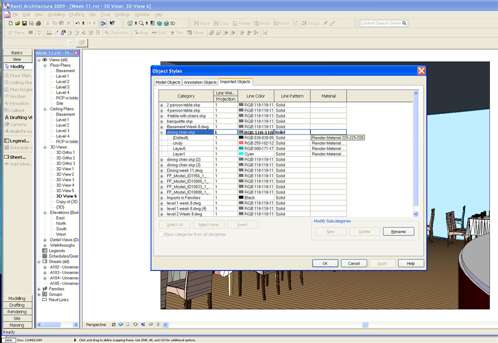

I have attached files showing the render, the "shading with edges" view, and the object styles and materials dialogs.  As you can see I have a lot of imported objects and the list of imported "render materials"is fairly imposing. All Sketch-up objects are rendered gray. Please note that the space is still a work in progress and few finishes (and little lighting) have been applied in Revit.
I am not sure what is my next step since the dialogs in your 2008 video do not match up with 2009.
Also, once we work this out, how (other than trial and error, which will take a long time on a project this size) do I determine which item on this list applies to where on the imported object.  For instance this simple chair appears to have 3-4 render materials, 2 of which I assume are colors and 2 are textures (fabric and wood)? Clearly, in the object styles, the line colors are not what I had chosen.  Does this matter?

Hi, see the video:http://screencast.com/t/9u0uk7Sjt0A    you must use "families" (like in video) to control the Materials objects, you DON'T need to buy anything... i create the other video in 2008 because i was render in 2009....

Thank you, thank you, thank you Typhoon! This is exactly what i needed.
