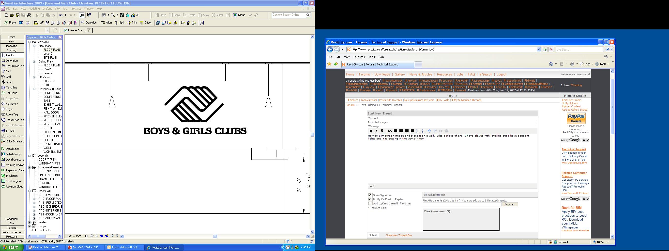

How do I import an image and place it on a wall.  Like a piece of art.  I have played with layering but I have pendant lights and it is getting in the way of them.  I have enclosed a screen shot of the problem.
Thanks AAron

Use decal.

Yep, use a decal to that but if you want the "Letters" in 3D use Model Text and ONLY the Symbol is a decal....

Thank you,  I looked up decals and they are only viewable in renedred views.  Is there a way to make them visible in non rendered views. Like a plain elevation?
Thanks again,
AAron

So, in that way i think i create Model Text to the letters and create a in-place Extrusion to the symbol...
