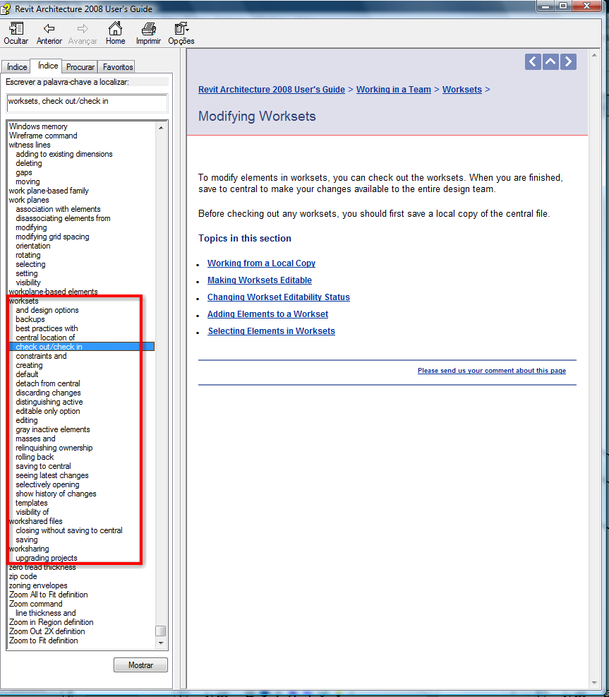

Hi, did you read before the HELP menu? It's very Helpful....

You probably do not share the central file with your consultants so don't look at checking out worksets.  Instead, read up on the Copy/Monitor process.  Very complicated but this is something you need to learn.  Also read the discussions here and on AUGI about the copy/monitor process.
