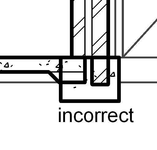

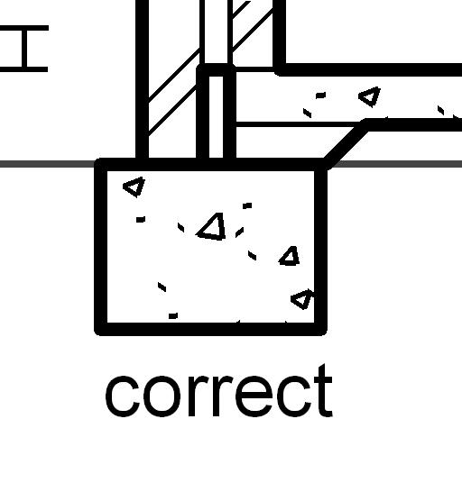

Using Revit Arch. 2009 and am adding a foundation to a cavity brick wall. Outer leaf of brick work extends below inner leaf. On some walls it attaches to outer leaf on others it attaches to inner leaf. I need it to  attach to outer leaf of brickwork every time. I cannot flip the wall because inner and outer are different thicknesses. What am I doing wrong? How do I change the wall or foundation to attach where I want it?
Thanks

Hi, you can use the "Join Geometry" to clean that, also check in properties of the wall the "Core" position, if you change the "core" the insertion of the wall it's different if this is what do you want...
