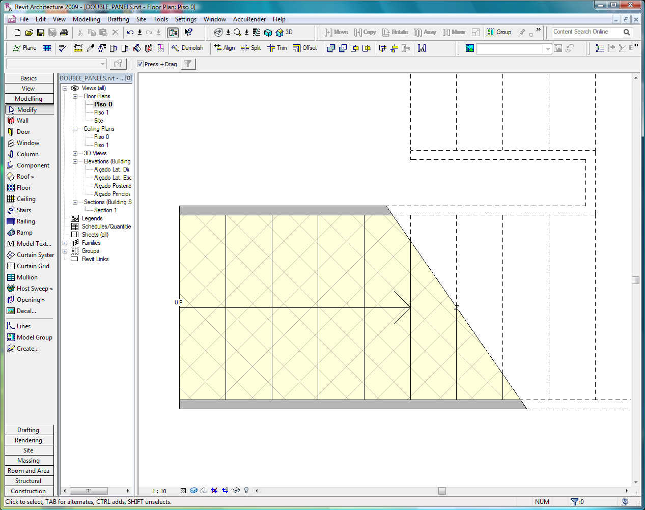

ok my surface patterns on my tread materials don't show in plan. Am I missing something here?
Fri, Nov 21, 2008 at 3:12:34 PM | Stair Tread Surface Pattern
Joined: Tue, May 22, 2007
5921 Posts
4 Stars: 205 Votes
like what? like this?

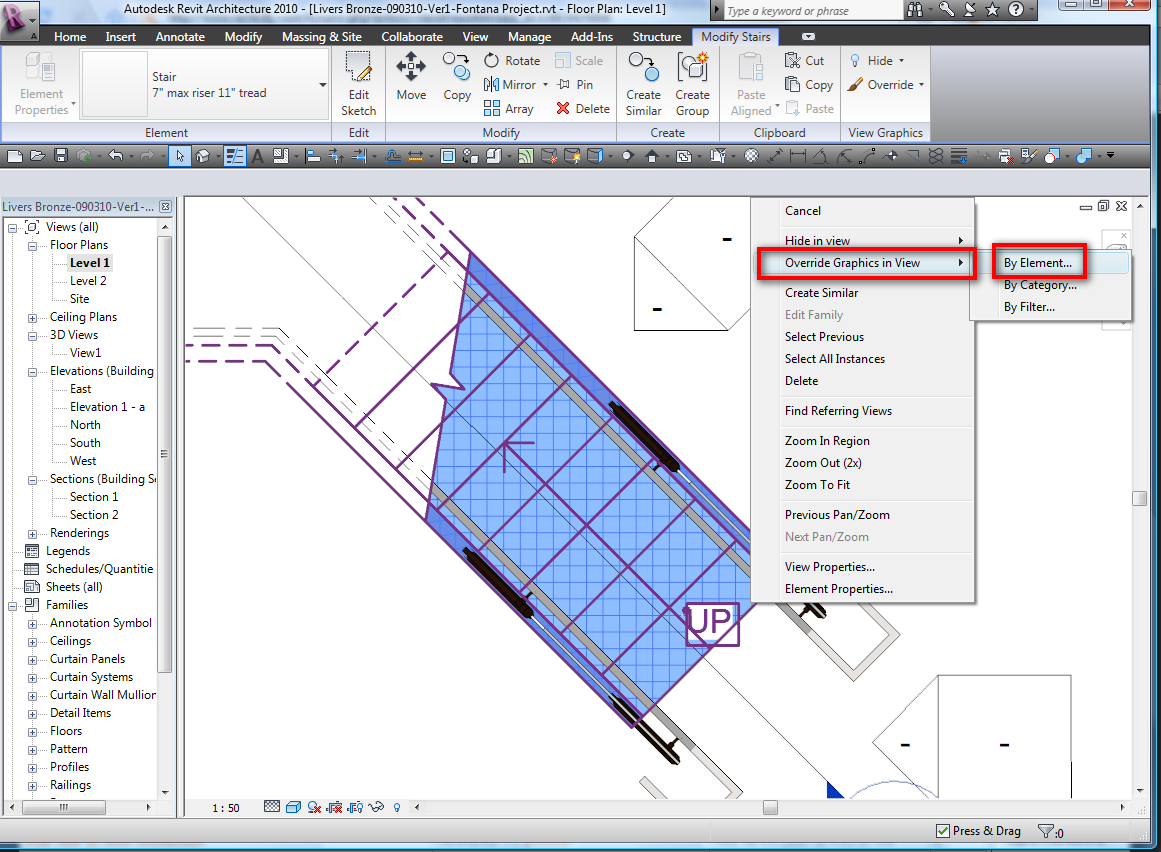

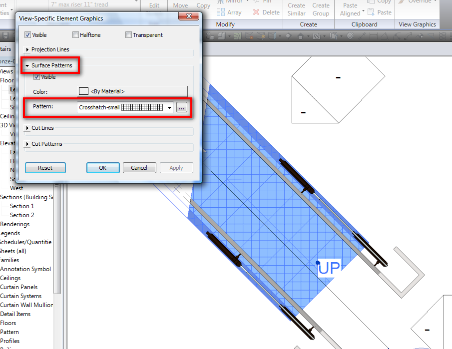

Override graphics in view might be one way to cheat the pattern into displaying, but you won't be able to use the actual model pattern, only a draft pattern.  Then the problem is that the hatch is no longer representive of an actual tile pattern since it cannot be adjusted, rotated, or sized appropriately.  There should be a way to get the model pattern to display in the plan just like with floor slabs and walls, etc.

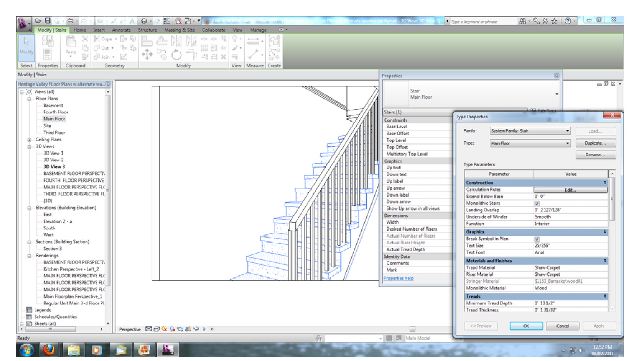

I've got a stair that I drew using boundry lines as well as risers, I assigned a material early on in the project and now I need to change the material. I selected the stair and changed the material of all the nessesary components, in plan it appears correct but in any 3d view i notice that the tread has not changed. If I draw a stair by run it assigns the correct materials but not if I draw a custom stair. All other stairs in the project appear correctly.  Suggestions?
