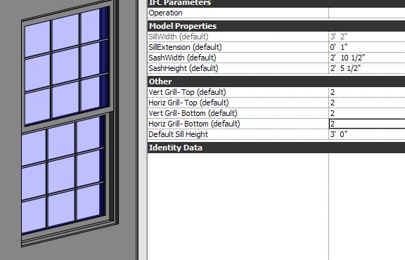

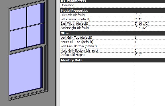

Fri, May 8, 2015 at 1:29:47 PM | Window Family with Muntins
What do you mean by 'interchange'?
The number of the muttins can be changed - both horizontal and vertical.
Rework their formulas.

Fri, May 8, 2015 at 1:33:03 PM | Window Family with Muntins
#9
ramirezo
Joined: Wed, Dec 4, 2013
0 Posts
I download it, and the vertical and horizontal mullions under "Other" are all greyed out. I only have the option between Traditional Grille and Prairie Grille. There are also no options under the Edit Type.
Fri, May 8, 2015 at 1:36:20 PM | Window Family with Muntins
#10
Edit the family and take out the formulas for the numer of muttins.
