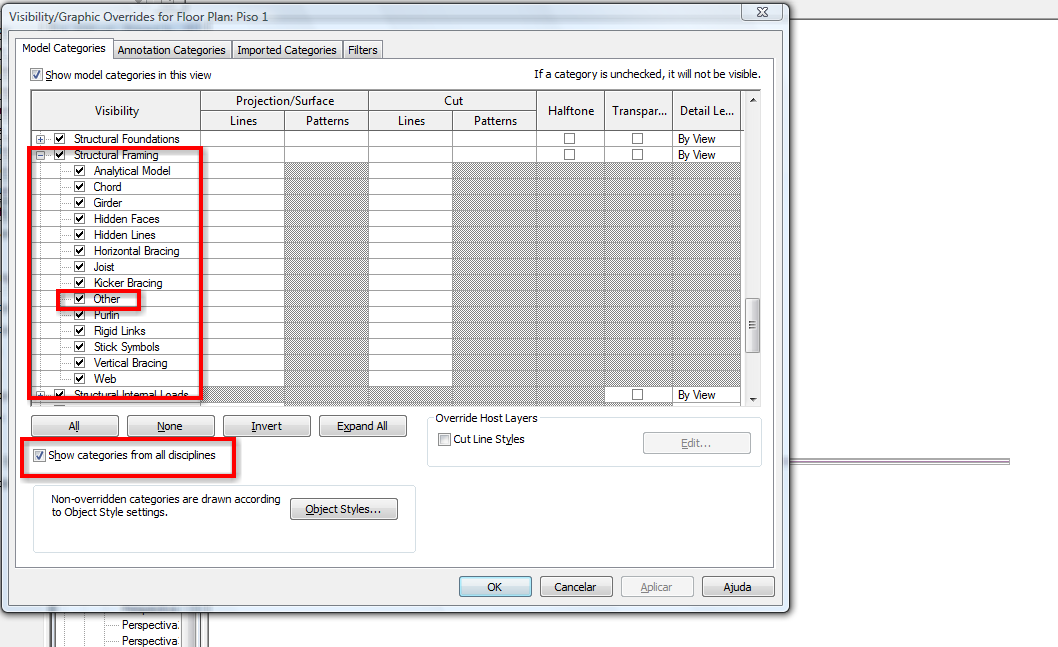

I am using Revit 2009 and am trying to make this command work, however it will only display the beams in analytical mode, is there a way of overiding this as I wish to display the full beam not just a line?????
 If anyone can help me ASAP as this drawing is urgent!!!!!
Thanks
Allan
Mon, Nov 17, 2008 at 12:40:52 PM | Create Beam on a Grid Command
Joined: Tue, May 22, 2007
5921 Posts
4 Stars: 205 Votes
Hi, go to VG and turn on the parameters "Other", see the image attached...
