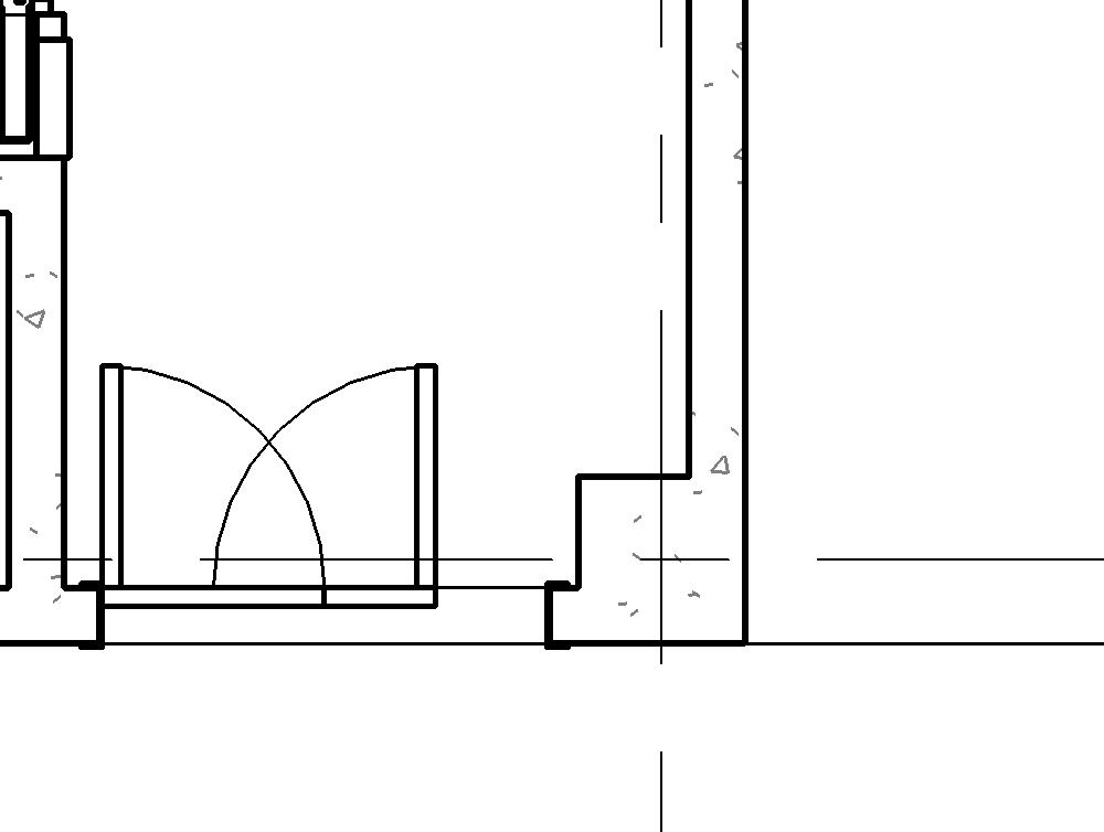

I'm trying to make a new door family which is a double flush door. Thing is that I'm not getting it that well done... When I try to change its width it all gets messy (see attached pic). What am I doing wrong and how do I correct it?

ops, I posted the family first... here's the image.

The symbolic lines you are using to define the swing aren't associated with anything. Constrain them by adding a parameter that will show the correct leaf size. Also you don't appear to have a left/right origin location. Select the centre left/right reference plane and set it to define origin. 2D elements need to be defined the same as 3D elements. HTH.

I made so many changes to this and so many saves that by the time I posted this I knew that there were things missing. No wonder it worked so badly. Thanks Mr.Spot Smile
