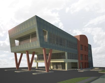

Is there a way to make a radius wall that leans out 3 degrees. This is my first project in Revit and trying to get this to work is driving me up the walls. Currently using Revit Arch 2009. I've attached a jpg of what I'm shooting for, the "red" wall is what I'm trying to create. Thanks

 Will this do? If you can make a mass of any shape, then you can create walls, floors & roof of most shapes.

That's what I'm looking for. I couldn't figure out how to get the shape to rotate the 3 degrees, I used a triangle mass for the angled walls on the side, just couldn't do it for the curved.

 Go to modeling, pick create and assign category as wall. Do a  solid sweep (see attached). You can also a massing with a solid sweep and use wall by face option to have the desired wall.
