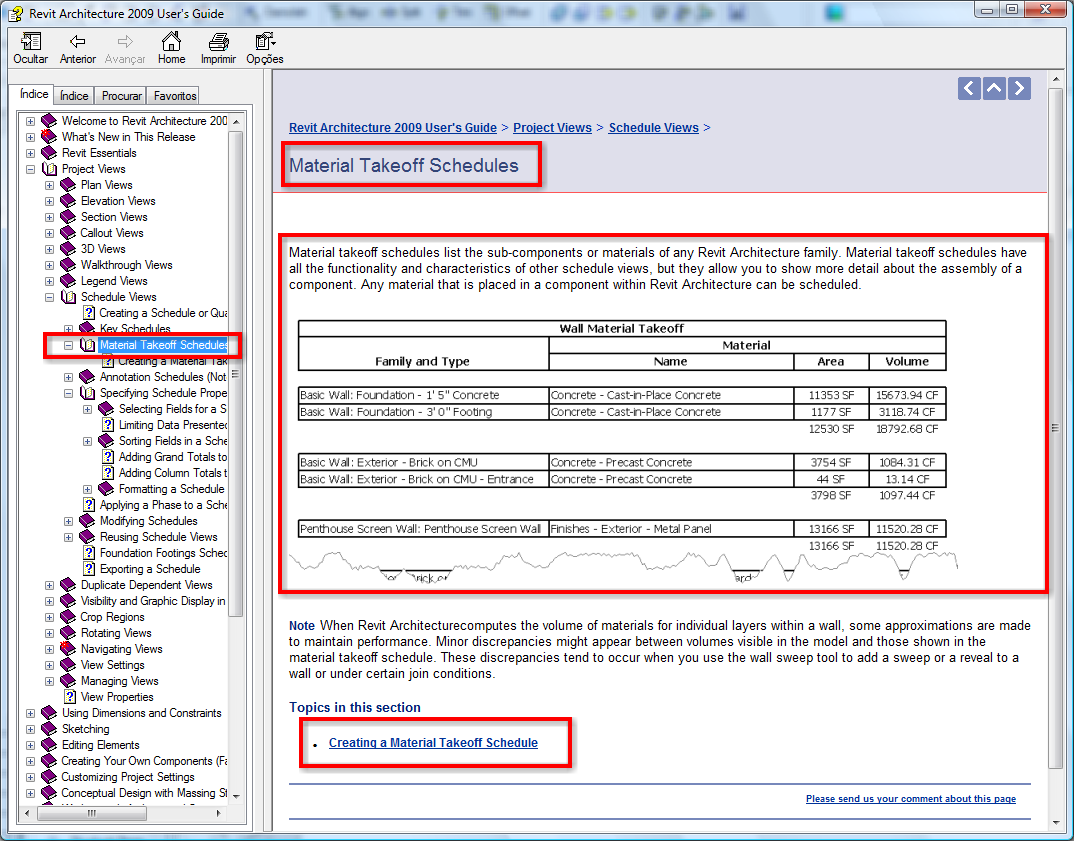

i have a query regarding the use of scheduling in revit. in architectural practice we calculate plaster surface areas or painting areas or finish areas . can that be done straightaway in revit with scheduling . i mean to use the structural properties of a wall or roof to schedule them .   because only those things can be scheduled which are parameters in revit . am i correct. but structural properties of wall or roof i e its composition are not included in its parametric properties. so how to schedule them .
i am using revit 2008. btw.

Hi 3D, see the "MATERIAL TAKEOFF" it's a detail shedule from what do you need, a good advise to you like a friend: you must read some GOOD books but FIRST take a look in your help menu and Tutorials, i told you before, the HELP in REVIT it's a "GOOD BOOK"...
