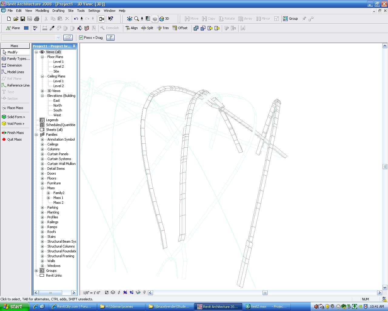

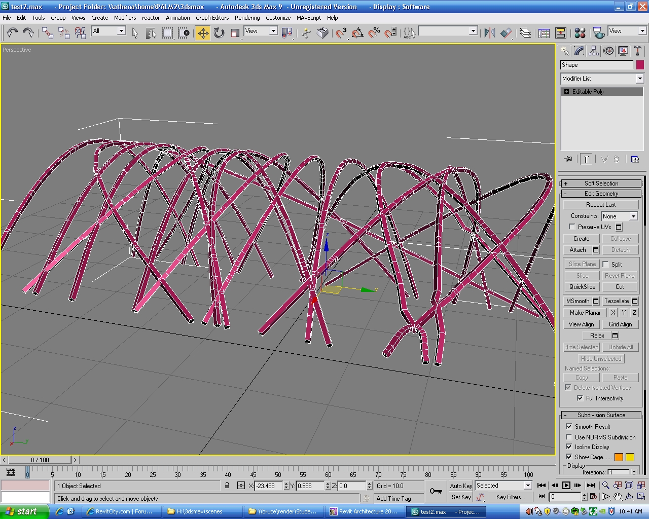

I have a mest that i can create pretty easily in 3ds max which i can then import using the .dwg format into revit and can of course create a wall from face from the mass. but it always comes through looking segmented and messy. unfortunately there is no way for to create the mass from the modeling tools in revit. so if anyone has any ideas about how to take this 3ds form and put it in as smooth walls in revit i'd love to hear it. I've attached the .dwg file below and some screen shots.

Try to create/export in ACIS solid, not mesh, the problem with mesh is that....
