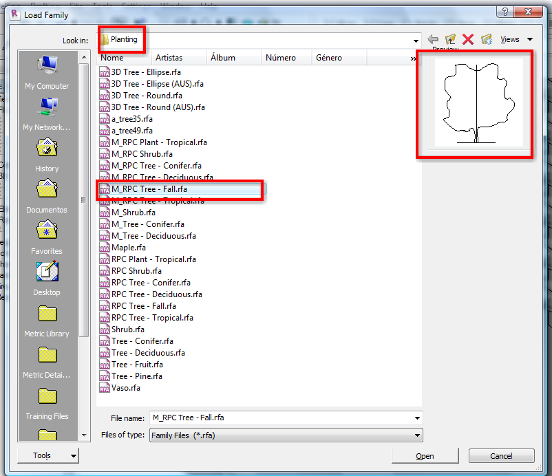

I cant get Revit Structure to render a tree- I checked the visibility option (vv) and nothing happens... can anyone halp? I see the tree before rendering in 3D view, but whwn it starts to render, it disappears

are you using the new RPC content for 2009 or the old pre-2009 non-rpc content?

I am vary bad at rendering actually... My main job is to design structural stuff, so I've never heard of something like RPC content. Could you explain? (I have the REVIT Structure Suite 2009 if it helps)

Hi, when you pick in "Components" go to "Load" and in folder "Planting" (see Image 1) you can choose the Tree you want and then the aspect in 3d view is like in image 2 attached...

thanks, it worked!
