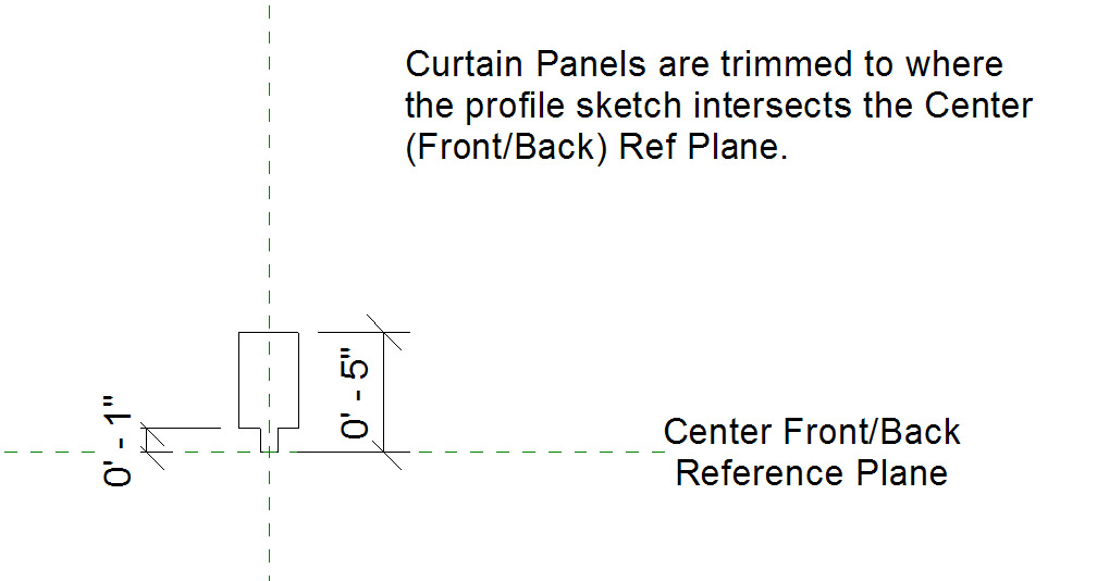

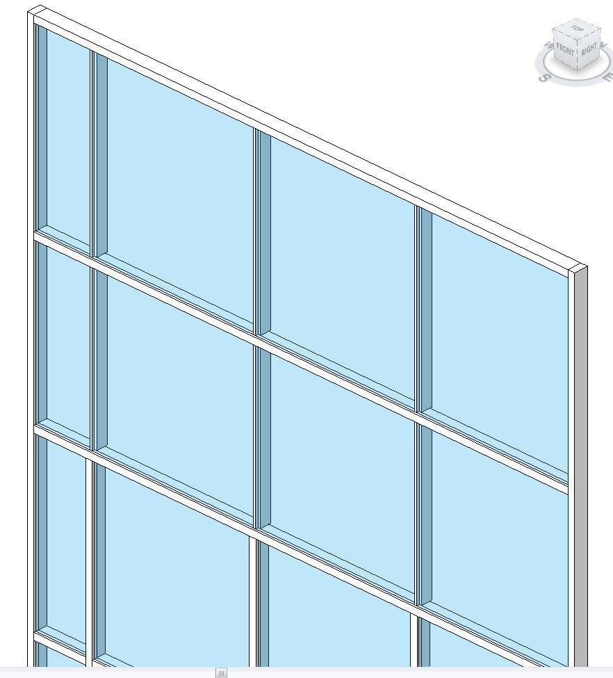

I made a mullion profile for a SSG type of application and when I put it into my project the glass panels do not trim correctly- see attached image.  Is there a way to make the glass panels extend to the actual mullion?
I am using Revit Architecture 2009.
Thanks in advance!

When you make a custom mullion profile, you will see the text in the mullion family that reads,"Curtain Panels are trimmed to where the profile sketch intersects the Center (Front/Back) Ref Plane."  So, if lines of the wide portion of the mullion touch the Cebter Front/Back line, it will use that width to trim the panel.  See the attached images.  I think this will do what you want.  Note that I made a new rectangular mullion using the custom profile and then I had to adjust the Offset of the mullion to pull it forward to be in plane with the glass.

That worked great.  I was afraid I would have to adjust all of the panels but your post worked like a charm!
Thank you!
