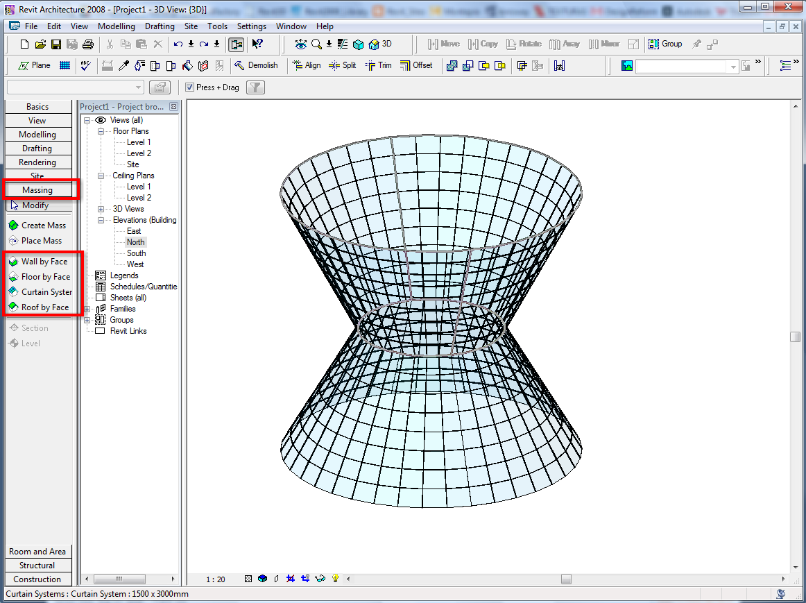

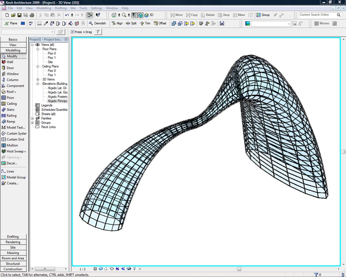

Hi, to create that kind of "Curtain Walls" you must use "Mass" objects then apply "Curtain Wall By Face", you can modeled in Revit or Rhino / Max (i prefer Rhino because is very simple and quick), you can crete that with Solid Blends, Extrusions, swept blend... in "Massing" menu.

To make this an Official Tips&Tricks thread, here's a short video demonstrating this technique:
http://gibsonhh.info/revit/video/curtainWallMassing.swf
Enjoy!
