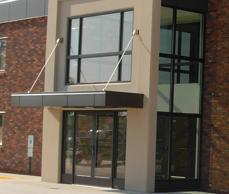

I have a 4'x12'x1' steel roof that has two support cables attached to the roof and the wall (see attached picture).  I have the roof done, but I am looking for ideas how to make the support cables.
Let me know what you think.
Thanks!!!

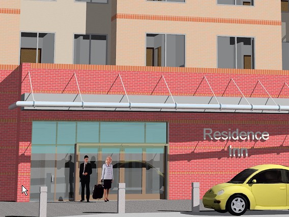

Attached is a study sketch I did back in 8.1.  The rods are simple extrusions.
