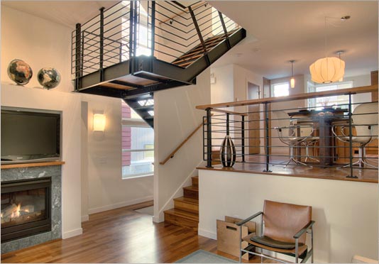

***let me show you a image of what I want to create****
And load up the beam that I want to use..

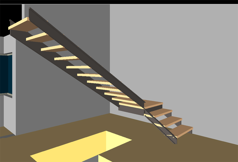

SO I kinda figured it out..But I run into the problem of the lower stairs showing thru.
And can I remove the ballisters?
