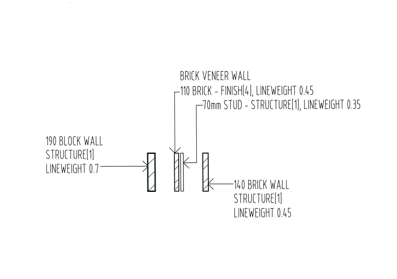

Hi All,
I am trying to set up a template that i can use for all new work that i do in REVIT 2009. I am just changing over from AutoCAD where i have penweights set up so that there is depth in my plans (see attached). I am able to set up basic filters in my view template for single skin walls but the problem i am having occurs when i try to create different line weights in walls will several functions (eg. structure[1], air barrier[3], Finish[4])
I am trying to do exactly what is shown in the attchment in REVIT but have so far been VERY unsuccessful.
I have spoken to many different support lines and teachers regarding this subject and none have been able to successfully figure out how to do it. It seems silly to me that a REVIT architecture doesn't deal with basic architectural convention like lineweights easily - unless I have been speaking to the worng people completely.
Any help would be greatly appreciated.
Thanks, Matt

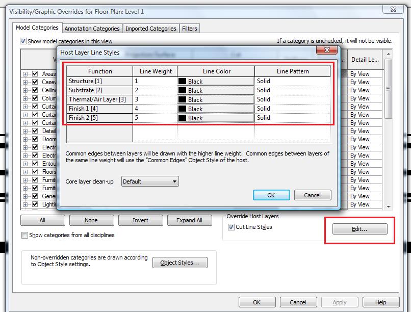

First things first. See the attached image file. Go to visibility graphics (VV or VG) quick key. Click on Override Host Layers. This will allow you to add what ever line weights you need.
Second thing: Think of the Revit transition like going from Hand drawings to Cad. When that happened you didn't expect you drawings to look the same. Actually it was quite difficult to get the drawings to look good at all back in the day. Going from Cad to Revit is the same thing. Your drawings will "not" look the same.  Hopefully they will look better. Go back to basics. I would not start out trying to get Revit to look like Cad. In Cad the temptation is to draw everything all the time. Even at very small scales. Start over with your "Cad" standards and make new "Revit" standards.

Thanks for that. I do understand what your saying. REVIT has some amazing capabilities that AutoCAD did not. Your solution will work for smaller jobs. Many of the big jobs we complete here however use several different structural wall types with varying types of cladding all requiring different lineweights. Overridding host layers and assigning a line wight to 'Structure' in these cases means that a 'structural' brick and a 'structural' reinforced concrete wall would be the same lineweight. Throw a brick veneer wall and a timber stud with NRG cladding into the mix all in the same view and i have massive lineweight problems. When printing people find it harder to read the plans and distinguish between things because it all appears flat and uniform.
Before REVIT i had used ArchiCAD also and when creating wall types you can assign lineweights to every element in the wall type. This was a very simple way to control linweights. I was hoping REVIT might have the same sort of lineweight controls and that i was just missing it somewhere.
EVERYTHING is possible in REVIT. This must be possible i just have to find a way.

Its good to finally find someone trying to do what i have been struggling with for so long. In short the answer to your question is no. There is no template, unless you create your own, that will be able to let you control your lineweights the way you want to do it. And even if you make your own it probably wont work the way you are trying to do it. Since i started REVIT six weeks ago i have been trying to find out how it can be done because my offcie uses similar convention to what you seem to be using. I spoke with a rep from Autodesk who told me that (unlike its competitors) REVIT had many other bugs to be fixed than to worry about making lineweights easier to use. It was not confidence inspiring but i still agree irregardless of that, REVIT is a first class drafting tool.
With all that said there are ways to do what your asking.
In my office over the last few weeks i have created a template with all the different walls types, dimension styles, text styles etc that would generally be used in our projects.
It IS possible to create filters that control single skin walls. (eg concrete block or single stud) I have created these so every single wall will show at the lineweight i specify.
The main problem is in the way REVIT makes walls with more than function. Now there is a way to do this but only to a certain extent and it probably wont work with your depth of lineweights. If you go to Visibily/Graphics Overrides there is an option 'Override host layers'. If you tick 'Cut line styles' and Edit you can change the line type and lineweight for each different wall function. So you can show structure[1] as a thick and Finish[4] as a thin line. Once you change these you then need to create a view template that you can apply to all relevant views in your project.
HOWEVER, lets say you change structure[1] to be 0.7 lineweight for example. EVERY wall with that function will show the same. SO if you have a structural stud wall, structural brick and structural concrete block all in the same view they will all show at 0.70. This might be fine for your concrete block wall but im sure you dont want you stud wall to be that thick.
Because of this i have pretty much left them as they are.
The way i have done it is by making my own linestyles. In your settings menu you have a table under lineweights and a number corresponding to each different lineweight. In settings under linestyles you can add your own types of lines, dashed, thick thin, any combination. Once you have done that you can assign them to lines in your view by typing LW, choosing from the drop down menu and selecting the line you want to show thicker. If you use 'cut host layers' as well as linestyles it can be less tedious but its the only way ive found to produce drawings that look the way i want them to.
Hopefully this helps. If you find a better way to do it PLEASE let me know.
