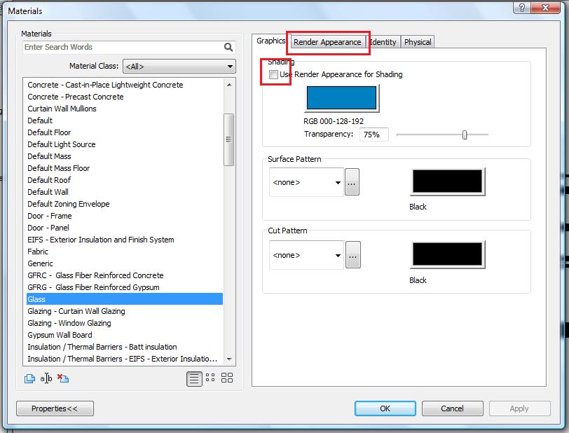

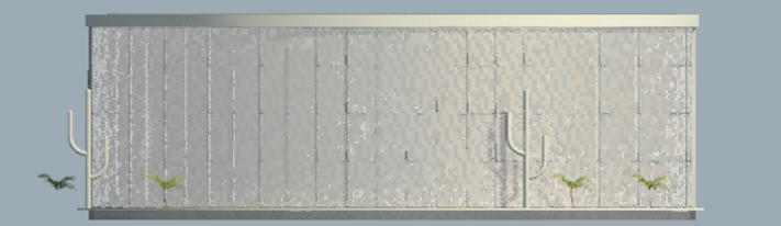

I want to render a view of my building looking inside from the outside..But the glass is totally opaque. I can't see through it when I render it.

Check the "rendered" material. See attached Material Dialog image.
