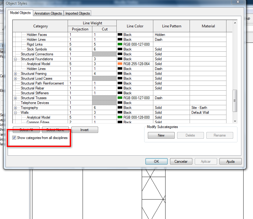

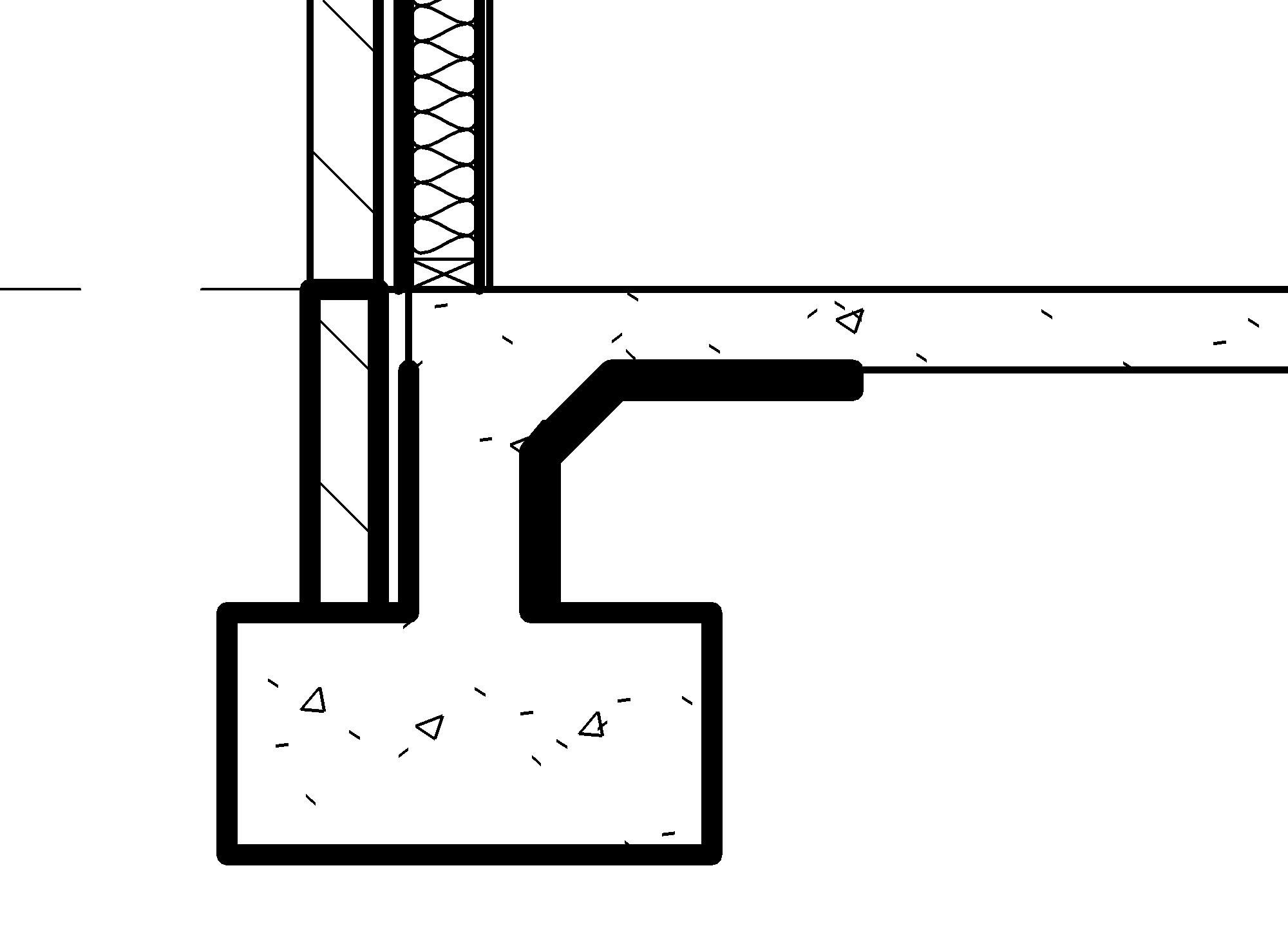

RAC 2009-I have adjusted the object styles to lighten up the cut line in sections of my walls, floors, roofs, etc.  I have three floor sweep profiles.  One is a footing, the other is the foundation insulation , and the third is the below finish floor masonry that rests on the "brick shelf".  I cannot find where to change the line weight on these sweeps.  The floor and wall are on the Object Styles list and they adjust just fine.  There are no sweeps on the Object Style list.  Where do you control sweep section lineweights?

Hi, did you check "Show Categories from all disciplines"?

Some foundation items showed up, I changed them all to the 3 lineweight and one of those fixed it.  Thanks.
