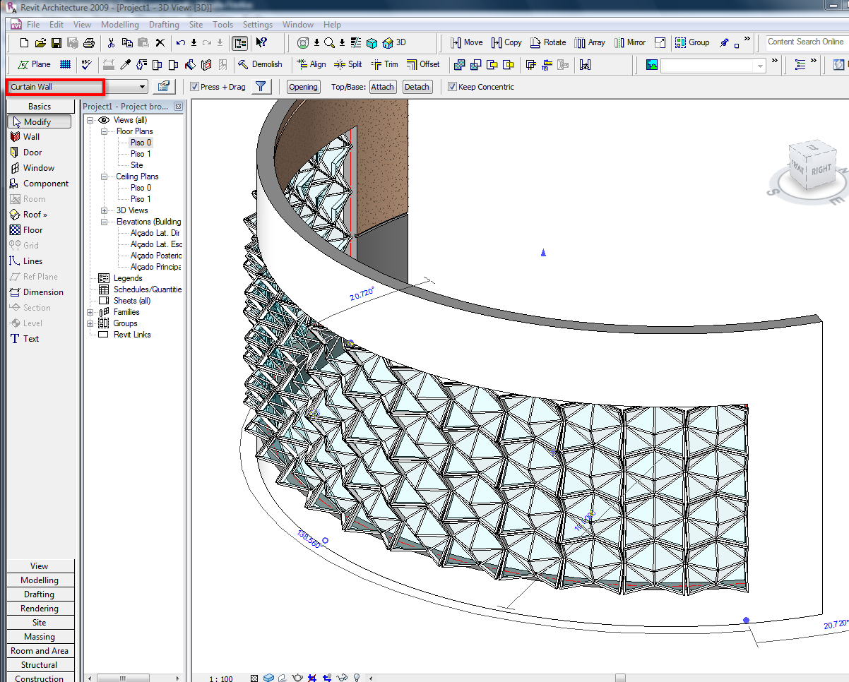

Hi, you have several ways to do that, if you want to open a opening in a wall (no matter if is curved / slanted), you can create a family "Generic Model Face Based" or a "Generic Window or door" and draw the shape you want then load to the project and "insert" that where you want, but the problem (if i understand the question because i'm Portuguese and sometimes my english isn't so good and i missed the question) is you want a "Wall Curtain Panels" to do that, so my advise is create a "Metric/Imperial Curtain Wall Panel", you don't need to create that family in curved because when you draw in project you draw in "Arc" but you must create in the family the shape and parameters with dimensions/angle to can control what do you need....

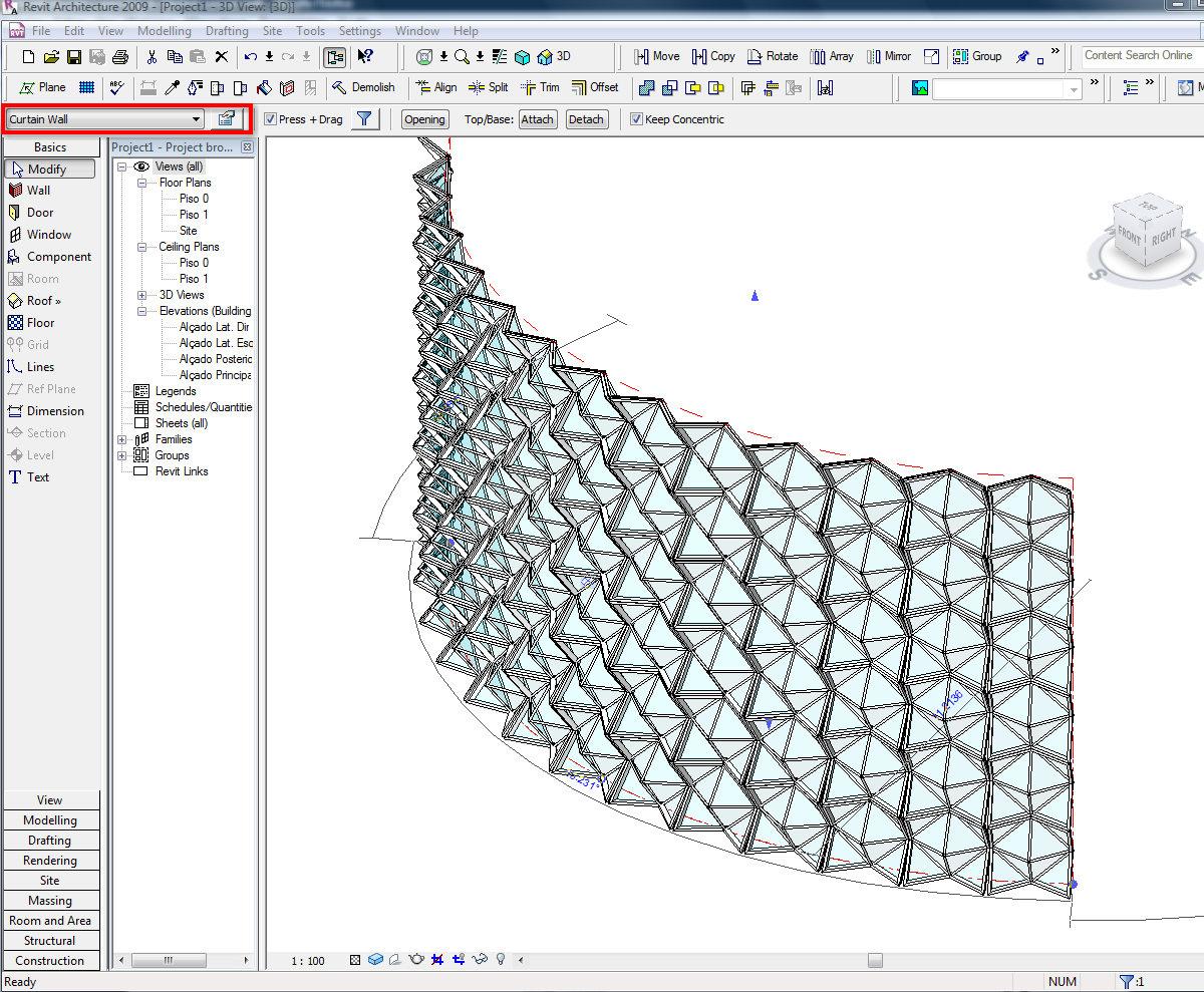

Lo que te queria decir es que quando dibujas el curtain wall panel em planta lo dibujas en arco, no necessitas de crear la familia en arco pues quando lo dibujas em proyecto creas un arco, tienes que crear una familia "FILE>NEW>FAMILY" y eliges "Metric/Imperial Curtain Wall Panel"
Mira estos sites, lo k necessitas está aqui, essa imagen que tienes si puede acer en revit, si entiendes bien el inglés no tendras problemas, mira estos sites, tienen videos para te orientares mejor:  http://designreform.net/category/revit-tutorials/page/3/
e tambien mira esto:  http://do-u-revit.blogspot.com/  e este tambien:  http://irevit.blogspot.com/
en el site "Designreform" cada imagen es un video e tienes vários....
