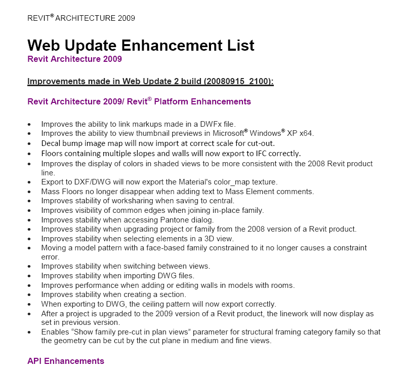

Hi TAB, i don't know if that Revit you purchase it has already the new service pack, take a look here: http://usa.autodesk.com/adsk/servlet/item?siteID=123112&id=11017599
I hope this solve your problems....

Many thanks Typhoon, I'll give it a try.
