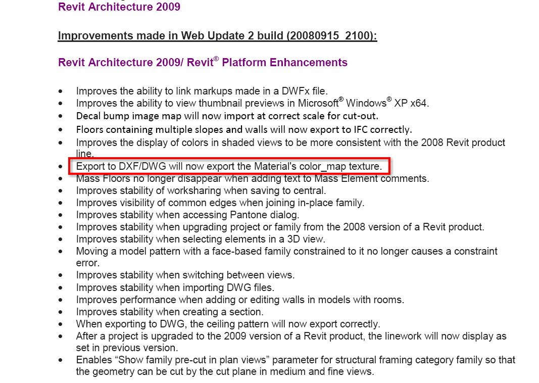

Hi, i think you must update the new "Web Update 20080915_2100" for Revit Architectural 2009, like you can see in the Web update Enhancement list", they solve some issues to this version, this is the link: http://usa.autodesk.com/adsk/servlet/item?siteID=123112&id=11017599

WOW!!! I took a look at your picture attached... I'll try to update my version! I hope it will help.. Lots of thanks!!!
