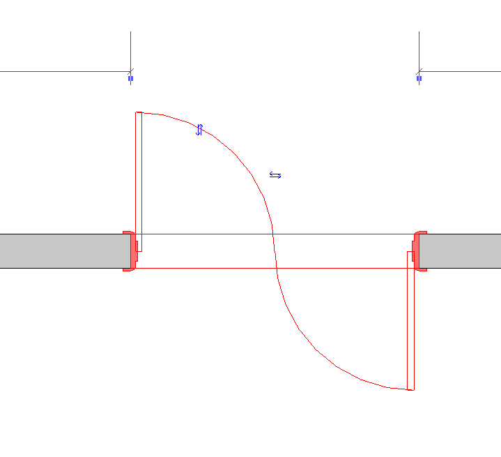

We're building a _really_ simple warehouse based off a very simple blueprint.
My problem is that I have to build two different types of doors and I have no clue whatsoever how to create them.
The basic doors are no problem but I think the other two are a bit special. I'll give you a link below so that you can see which doors I'm talking about (the ones with the red circle around them):
Link:
http://img227.imageshack.us/my.php?image=revitdoorsxm7.jpg
Would appreciate any help if you know how to make these, just remember - I am really noobish Winking

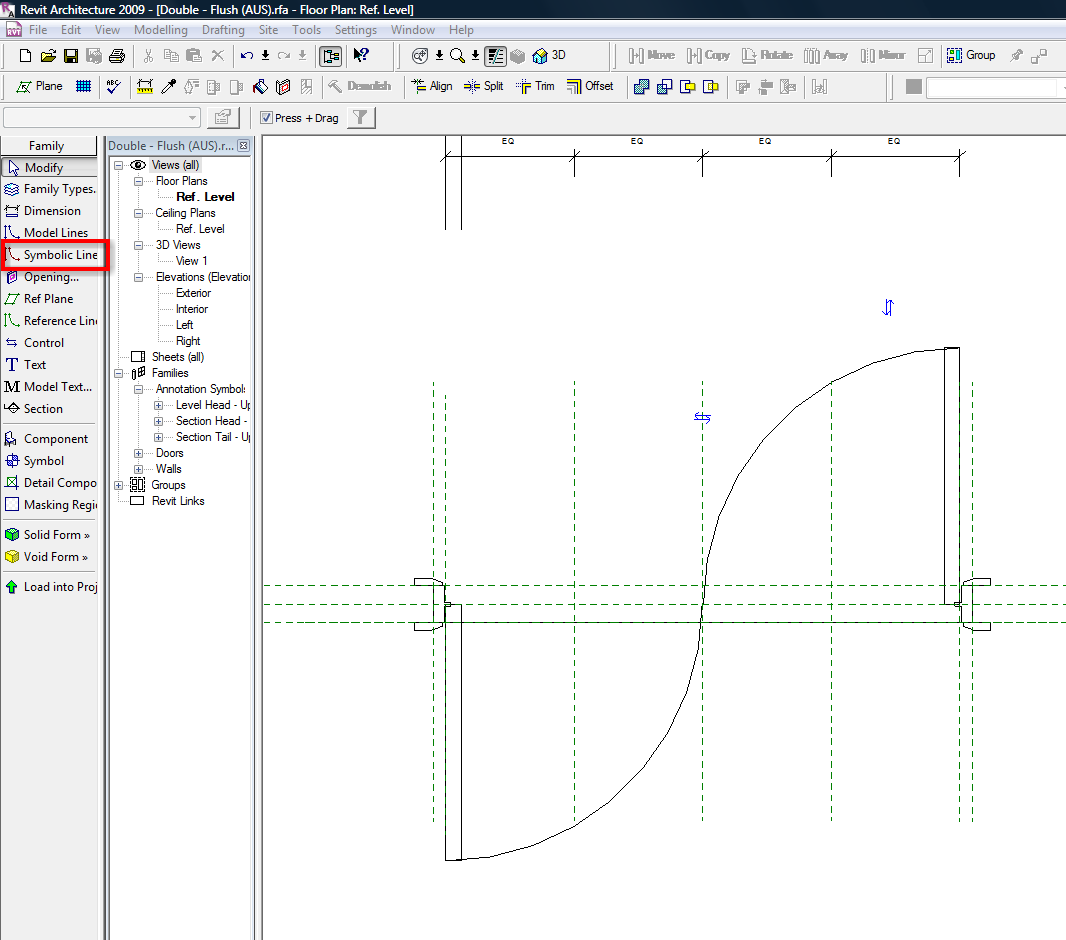

You can do that with "Symbolic Lines - Plan Swing (Projection)"...

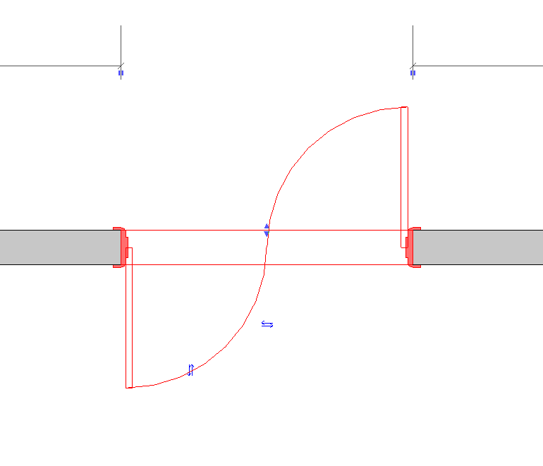

" how did you actually make it and will these lines really look like an acutal door?" well you can create this in a family door or you also can open an existent double door and change in plan this "symbolic lines" like you can see in the first image...
