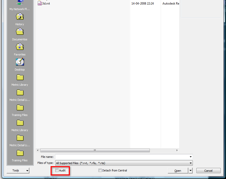

Hi, did you try "Audit" the file when you Open??

Yes, I ran audit on all the files and back up files.
