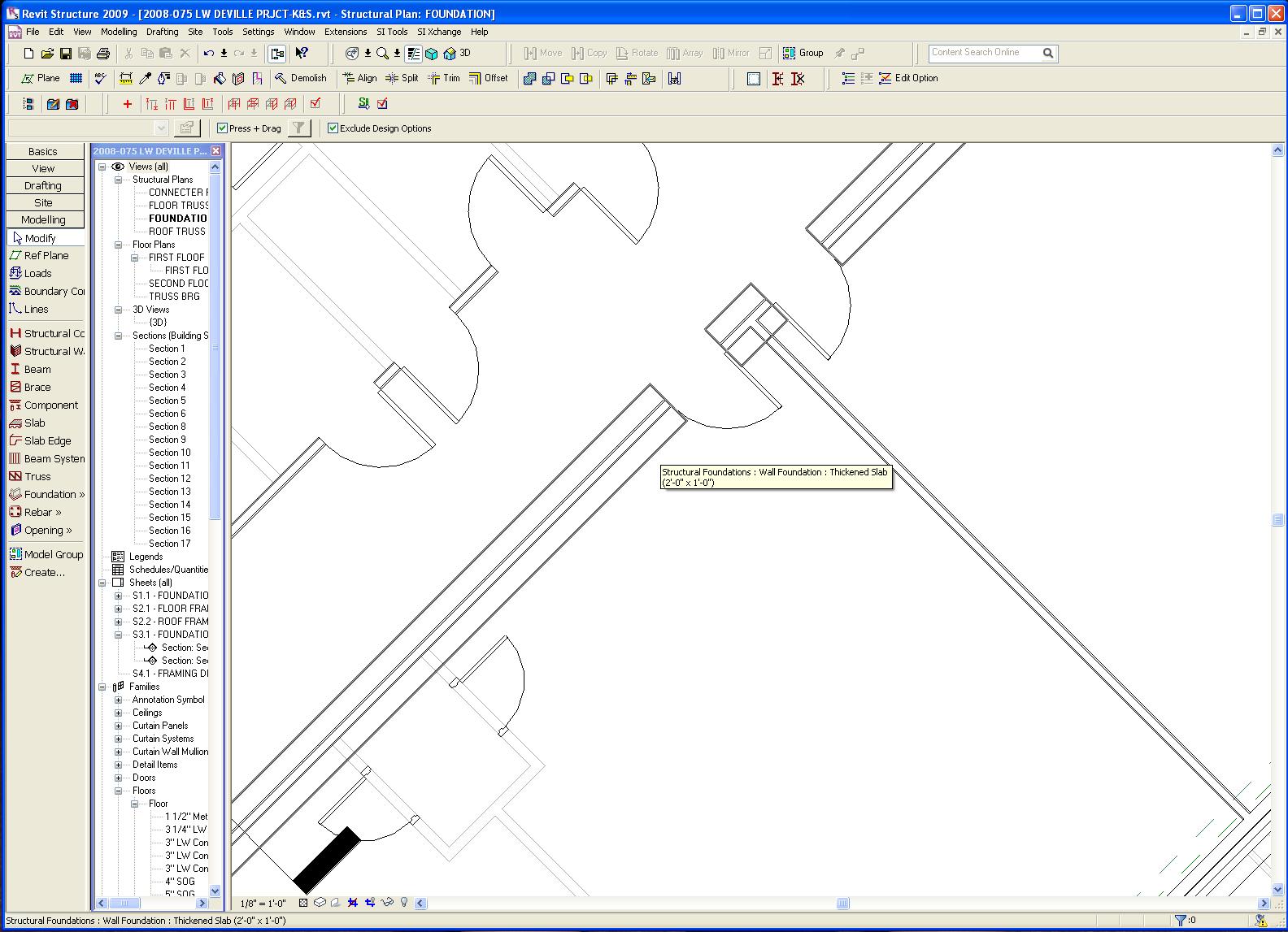

Is there a way to make the wall footings (thickened slabs) to pass thru openings in plan view?  I am putting a thickened slab under an interior wood stud bearing wall, but on the plan it stops and starts back at all doors.

Hi, can you put some screen shots fo figure it out???

See attached screen shot.

Hi, see the video: http://screencast.com/t/vtJgwrPm

I figured out another way to do it.  If you change your "Sill Height" of the door to anything > zero, then your footing will show up.

Well, like i tell you in the video, i don't know how is your wall, but, what you say is your doors are attached to that "foundation Wall" isn't?

I don't think the doors are attached to the "foundation wall".  I think that in Revit, if you put in a length for your sill height then it puts a short piece of wall under the door equal to the height of your sill.  The wall footing then connects to this short piece of wall.

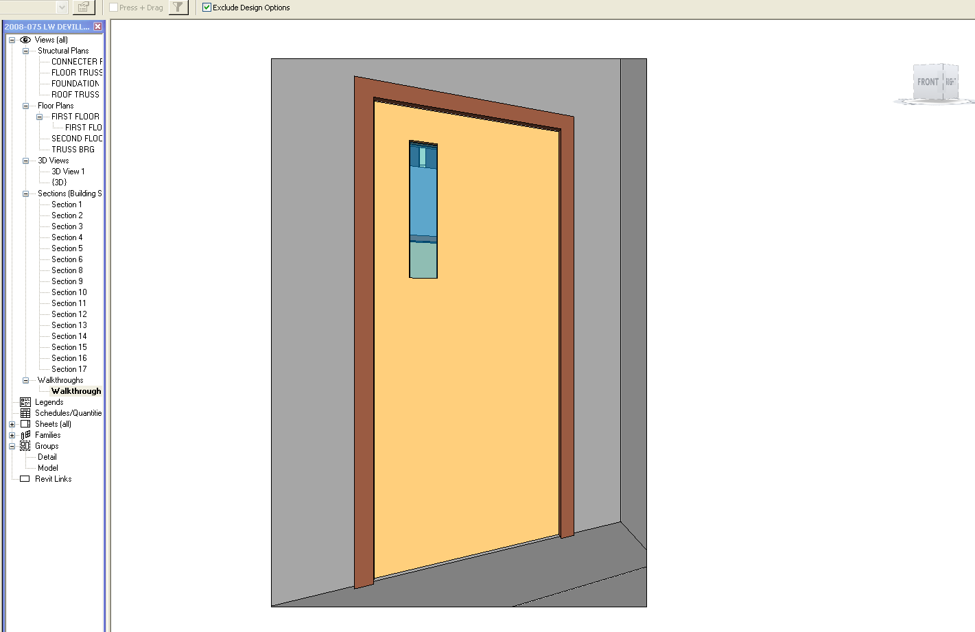

Can you put animage in 3D view to see those walls with the door?

Attached is a 3D image of the door.  You can see the line on the floor which is the edge of footing.  I put in a 1/2" sill height.  It doesn't appear any different than a typical door.
