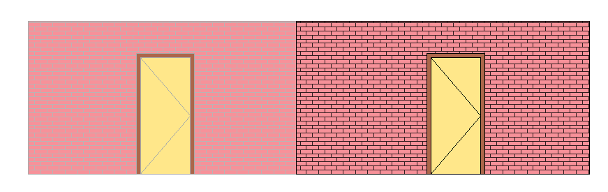

Hi, this is what do you want/need?
If it is, you can pick in the elements you want to change the tone and right click buttom of mouse and go to "Override Graphics in View > By Element" and Check on the box "Halftone", this is one wayto do this...
