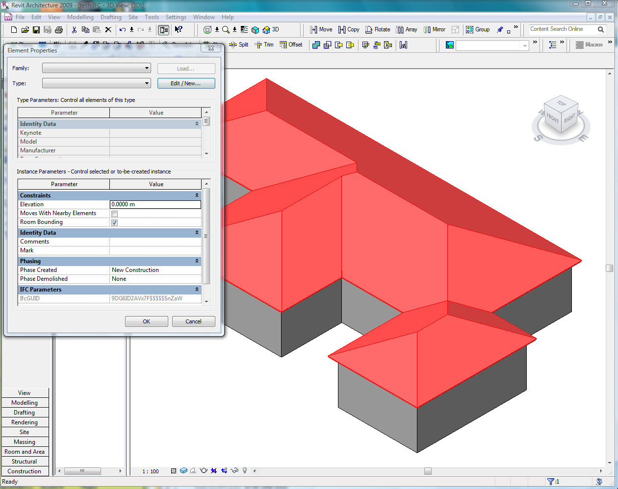

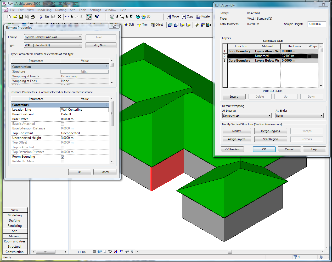

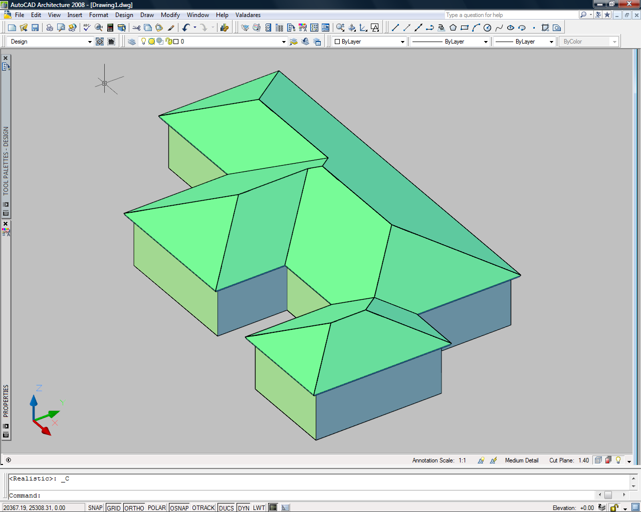

Well, you can export in IFC in CAD and import in Revit in IFC, like you can see in the 1º image is in CAD, then in 2º image you have in Revit the model and "He" recognize the "walls" but in 3º image "He" don't recognize the "roof" like a roof, only like a "imported" DWG, in the walls you can edit and change the profile and attach/detach but there are some objects "he" don't "like"....
