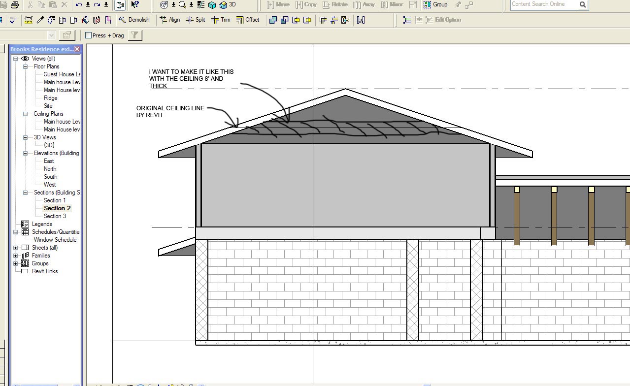

Got a room with a 4 12 hyp roof.
the top of wall is 6'2, but the ceiling is at 8' hi, so you have that little but of sloped roof at the peremeter of the room. how do you draw this? I tried the ceiling tool, it places  line in the section, but no framed ceiling with thickness. do I try to build a floor 8' off the regular floor and try to connect the geometries?

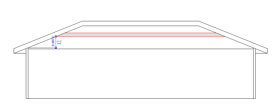

Hi, draw the ceilling then in properties you can change the heigh and the tickness with different materials and after in section you can use the "Join/Unjoin" command... see the pic. attached, it's what do you want?

so I was able to get thickness by changing the type of ceiling. but there still is no thickness option in the properties dialog...So im not sure how to get thickness still.

nvm i found it. thanks
