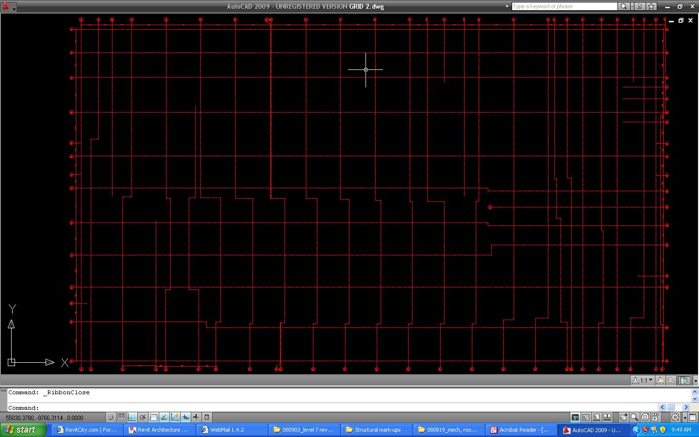

is it possible to make a grid line in revit 2009 having 2 or more offsets ... see the attached image..
Fri, Sep 5, 2008 at 6:59:15 AM | offsets in grid lines
The answer is no but beyond that, I don't think this is a good practice.  How do you really define where the jog occurs?  Give it a new number or 1.1, 1.2, etc.
