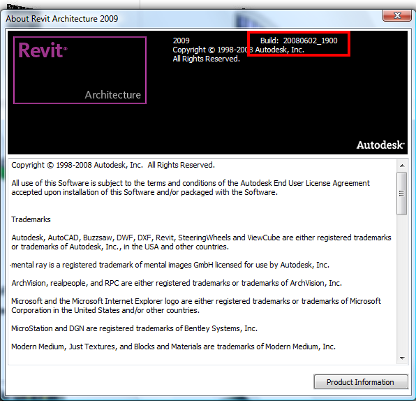

When I set up the view I want to render and then click "Render," things will go fine for the first few seconds. After about 10 seconds, the "percentage done" box closes, and the image becomes black. Adjusting exposure, etc. does nothing. This happens whether I'm using sun, sun and artificial, or just artificial. I was rendering in the same project yesterday! I'm thinking there may just be something w/ the project file because I can render in others... any thoughts???

Hmmmm, did you upgrade to the WEB UPDATE 20080602_1900 Revit 2009?

I don't think I have. Render works fine in other projects - it's just this one not working.

To check if you have upgrade go to "Help>About Revit Architectural 2009..." and appear a Box like image attached, see if your it's equal...

Revit closes the dialogue box (I have "close when completed" checked), and nothing's happening in the task manager.
It's an exterior shot - I've tried many camera angles, regions, sun/shadow settings...

Got it - some RPC people I'd dropped in seemed to be the problem. Weird. Thanks for the help!
