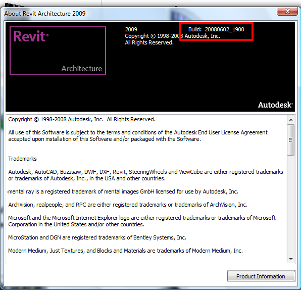

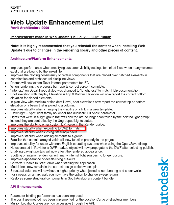

Hi there, you don't say what version of Revit you use, but, if you use Revit 2009 did you upgrade to the Web Update? see image attach. it solves many issues and Export is one of them...

Hey, There is the adress: http://usa.autodesk.com/adsk/servlet/item?siteID=123112&id=11017599
but check before in "Help>About Revit Architectural 2009..." the number , see image attached....

Do you download the "Revit Architectural 2009 (exe - 490 MB)"? and the file appears is "WU1_RAC2009.EXE"?
i THINK WHAT ARE YOU TRYING TO INSTALL IS TO REVIT ARCHITECTURAL SUITE 2009, is not that if you don't have SUITE...
