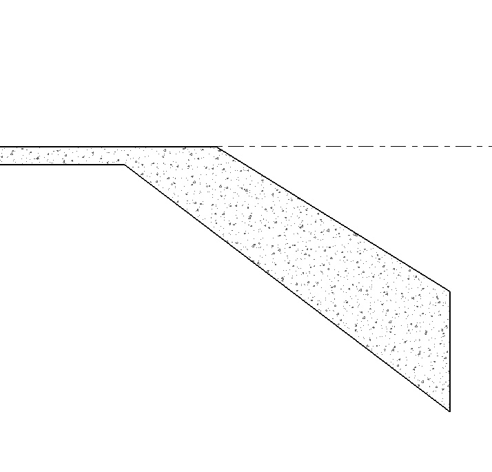

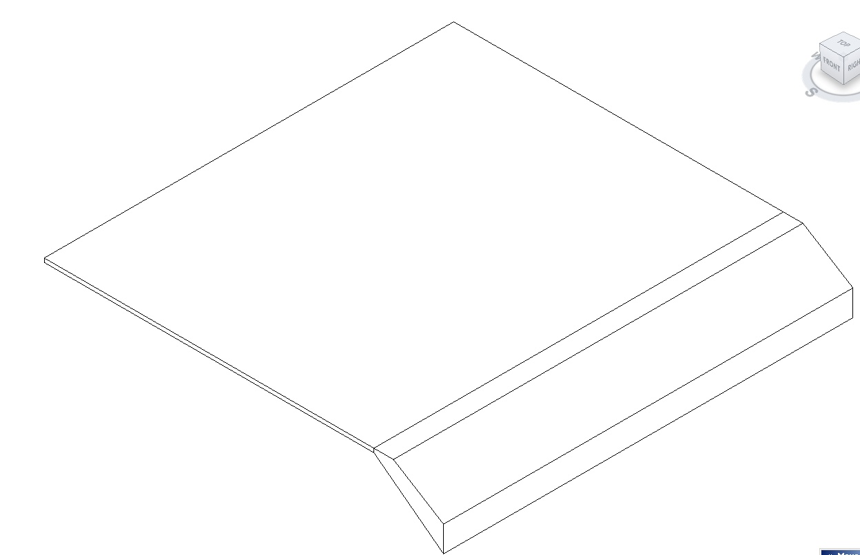

Has anyone noticed this problem before.
When joining 2 entities of the same material, they look grat in sectionn but the joint line doesn't disapper in plan or 3D
Any ideas for a solution.

And they are both to the same "category Family"? like Floor/Floor, Roof/Roof and so one...

Yes, both floors both conrete

Well, i do a Floor and a element "Extrusion" like you do, with the same material and category family "Floor" and i joinn the 2 elements and it's ok, don't see the line in section or 3d view....
