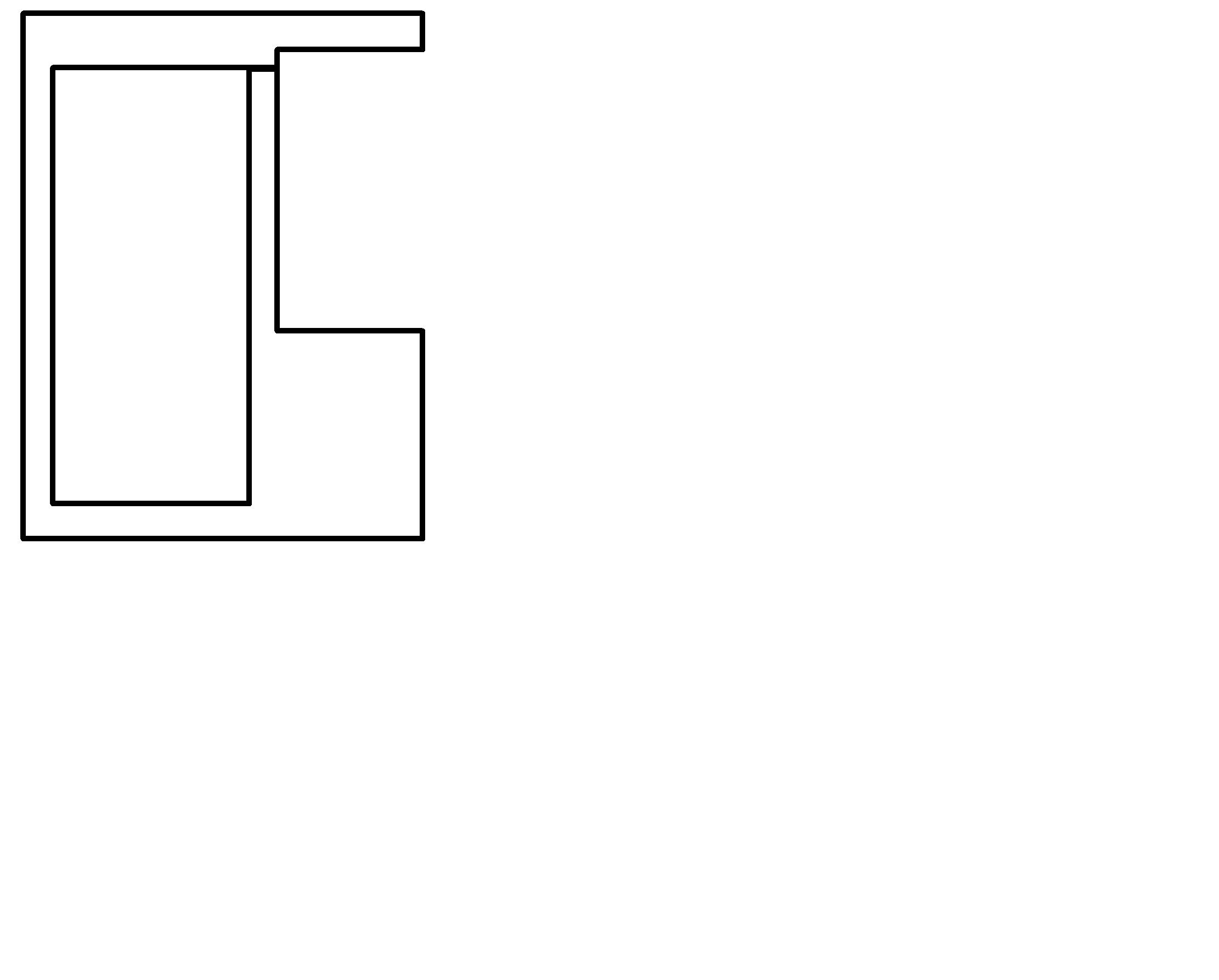

THIS IS A TYPE OF PROFILE I AM LOOKING FOR ...

You can create a mullion like that (i just did it right now), what you must to do is draw that shape BUT you must create 2(two) aditional lines (no matter where) intersecting the 2 lines (the minimum space beetween is 0.00021)" and trim each other to create ONE "polyline", did you understand?
