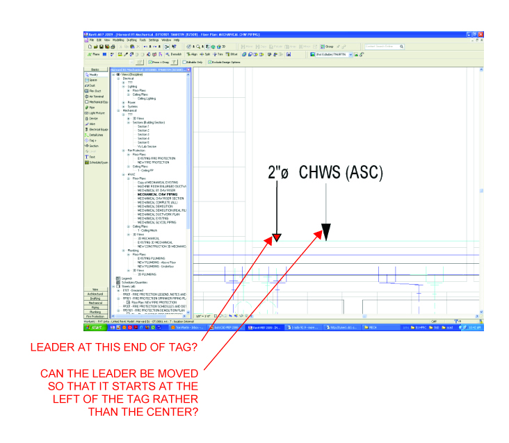

 I have a question in regards to custom tag creations with leaders. The Mechanical group has begun to create custom tags and ran into a question. They created a custom Pipe tag and added a comment parameter so that they could have the tag read the pipe diameter as well as note what type of pipe it is. Right now it seems that the leader defaults to the center of the entire tag. Is there a way to left justify the leader? Is it be a change made within the family or directly in Revit itself. As of now we could not figure out the anser so I thought I would give it a shot here and see what other people may suggest.
I bet this might be a simple question to ask but any help would be great! Thanks!
I have attached an example of the tag for reference.

The image didn't seem to work, so lets try a pdf.

I'm guessing that the text is centered on the reference lines in the tag.  When you are in the tag family editor you can turn on the reference lines by going to the visibility graphics overrides and then move the text and left justify it about the center of the reference lines.

Worked great. Thanks!
