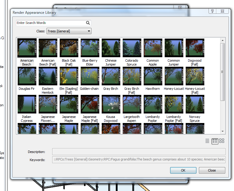

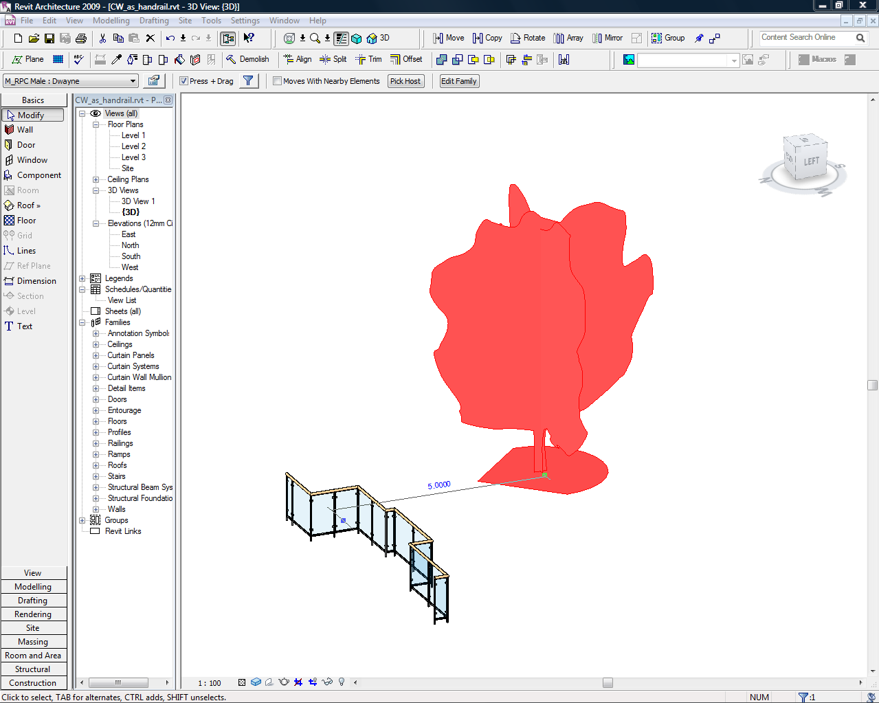

This is how they look like, see the images attached...
