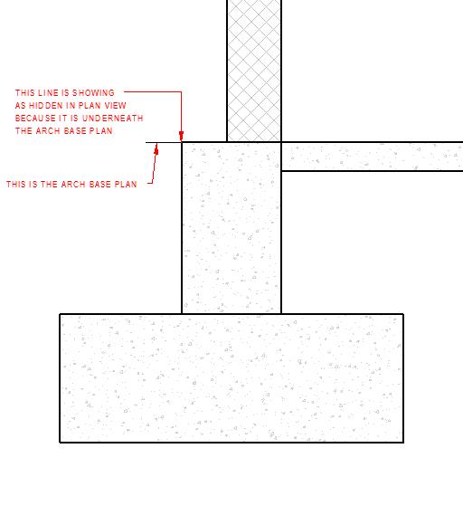

I've tried searching the forum for an answer but haven't really had any luck.
So, architectural base plan is imported/linked into RStruc first floor plan and it is set to half-tone.  Problem: the lines from the arch baseplan (face of brick particularly) cover up the lines for the stem wall below.  Make sense?  We've tried several things . . . none of which have worked.
We tried to override graphics for the linked baseplan and set it to transparent.  Didn't work.
We tried changing the elevation of the baseplan.  Didn't work.  Causes problems with other things.
We could use good ole AutoCAD to edit the baseplan so that we could freeze(hide) the interefering lines, but that could be really time consuming at best.
Any great ideas?  Am I missing something simple?

Mon, Aug 25, 2008 at 3:45:00 PM | Lines from Imported dwg are hiding model lines
Did you try setting the linked dwg to background?

I FIGURED IT OUT!!!!
When you import the DWG file, you have to select "Current View Only."  I didn't do that the first time. So, I deleted the baseplan, re-inserted it with the "Current View Only" option selected and . . . Voila!!
Thanks for your help!!
