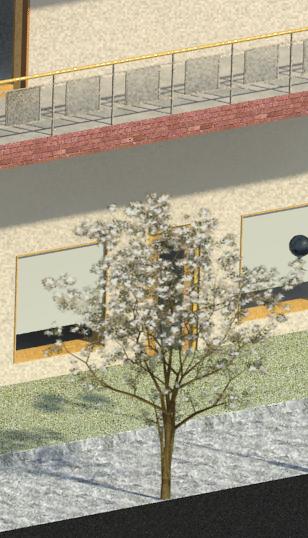

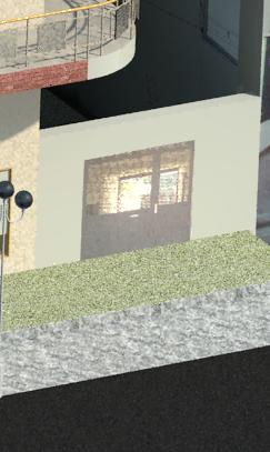

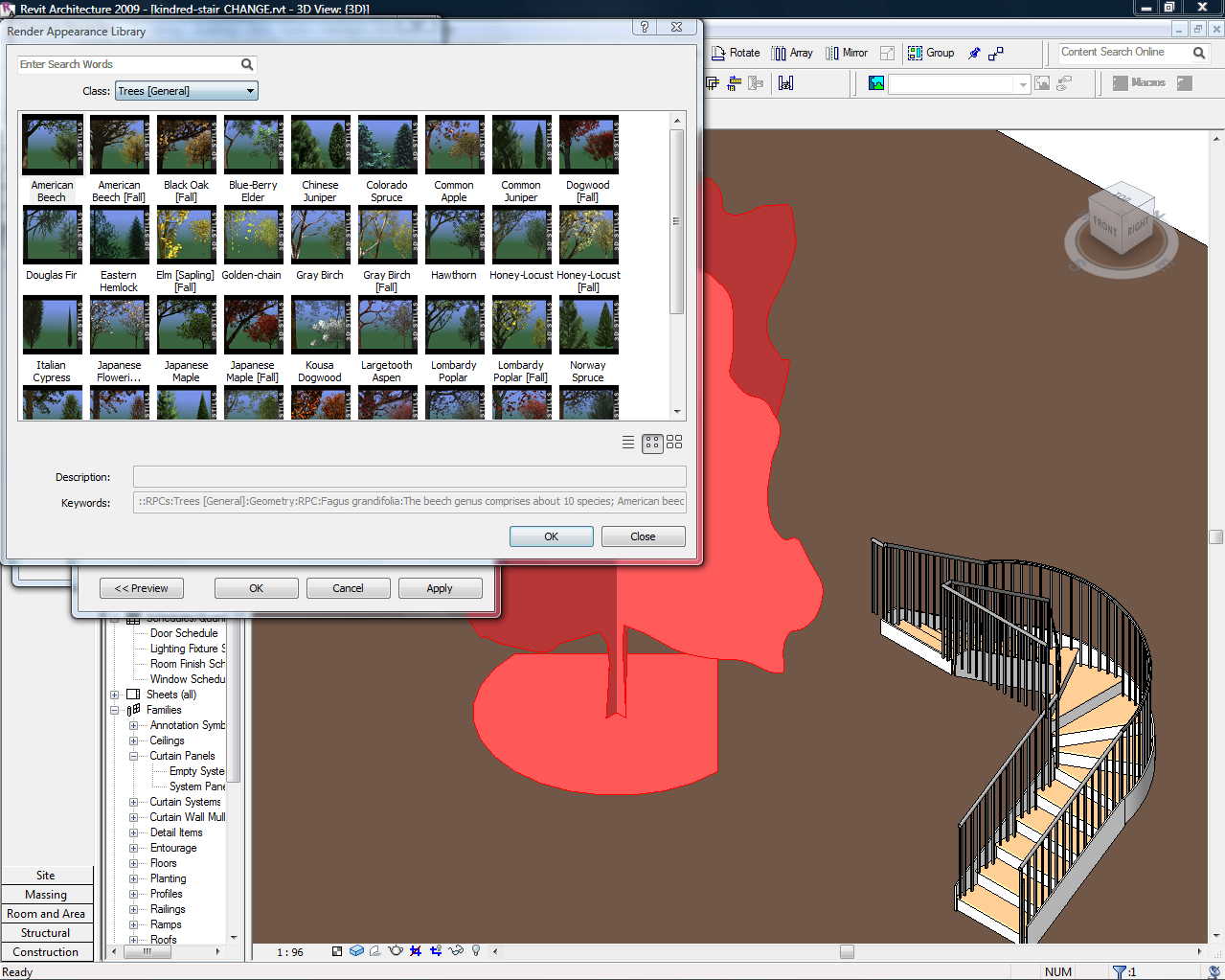

Hi ALC, can you put the image AFTER render to see the trees and see how they looks like?

Here they are

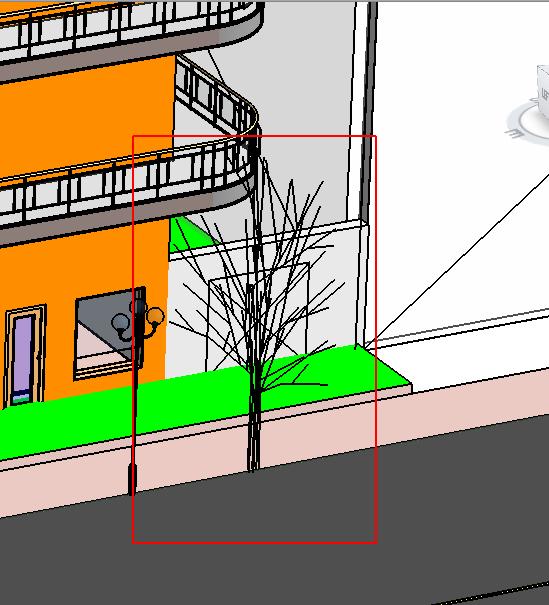

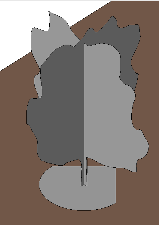

Hi ALC, i think you insert a OLD tree from 2008, so delete them and insert a RPC like in the images attached...

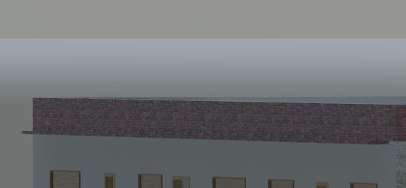

Now I have another problem: the sky is not rendering. I just got a grey generic material-like color.

You muts see the parameters in the SUN settings, go to settings or SU and check the date and hour, you probably has the hour near the sunset.... put the hour in i.e.= 15:00PM, 16:00PM and check...

Nope. I set at Summer 15 pm Buenos Aires
