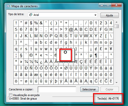

Coreed, i can't see the video, and i also use JING, take a look ....
Rwhite, if you use ARIAL font you can use "ALT-176" in the final of "30", in windows, all programs, Acessories, Character map uou can find what do you want, degrees, diameter...
