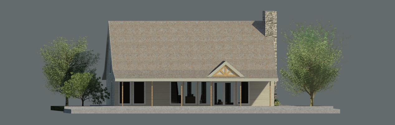

I posted about this before and still have not been able to figure this out. Anyone have any idea why I'm not getting a horizon. My settings are Exterior Sun Only, Sky: Cloudy. 1pm in Houston Texas.
This one really has me stumped.
Thanks!

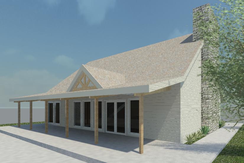

Hi, i do like you do, the hour, place, Exterior Sun Only, Sky: Cloudy. 1pm in Houston Texas, put "Sunlight from top right, i think this is what you do, and the Eye and Target elevation of camera is 1.75 Meters, you can see the image attached, did you upgrade your Revit 2009? the Web update....1900?

Thanks for your reply. As soon as I read your reply I realized what I'm doing wrong. I was rendering in the regular 3D view and not using a camera. It works great now. Thanks!
