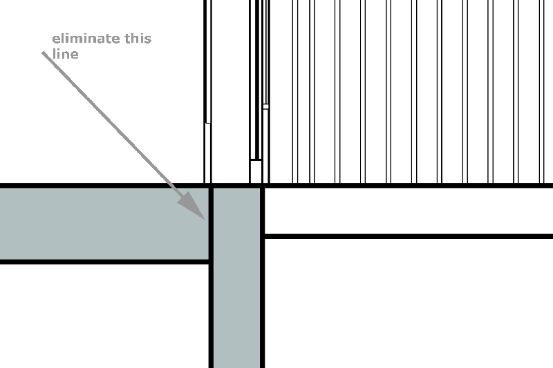

I want to eliminate the display of the common edge between walls and floors in section (see  image) but can't get it to work. any advice?

Do you use "Join Geometry" between the walls and the floor?
Mon, Aug 11, 2008 at 5:03:08 PM | eliminate cut profile in section view
Use your linework tool with an invisible line.  Hoover over the slab edge and when you have the slab, make that invisible.  Do this again for the wall but when you get this one, you will want to adjust the invisible line so that it only hides a portion of the line.  There should be blue grips that you can stretch into position.

Thank you, the 'join geometry' works. (It's soo obvious once you know which button to push)
