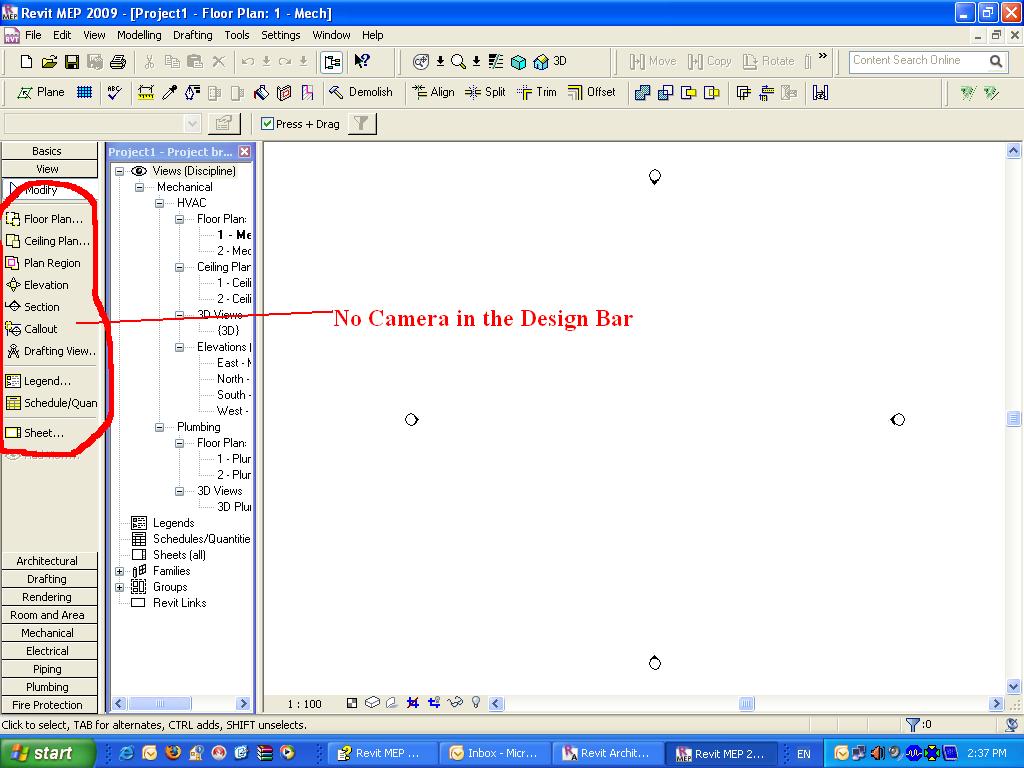

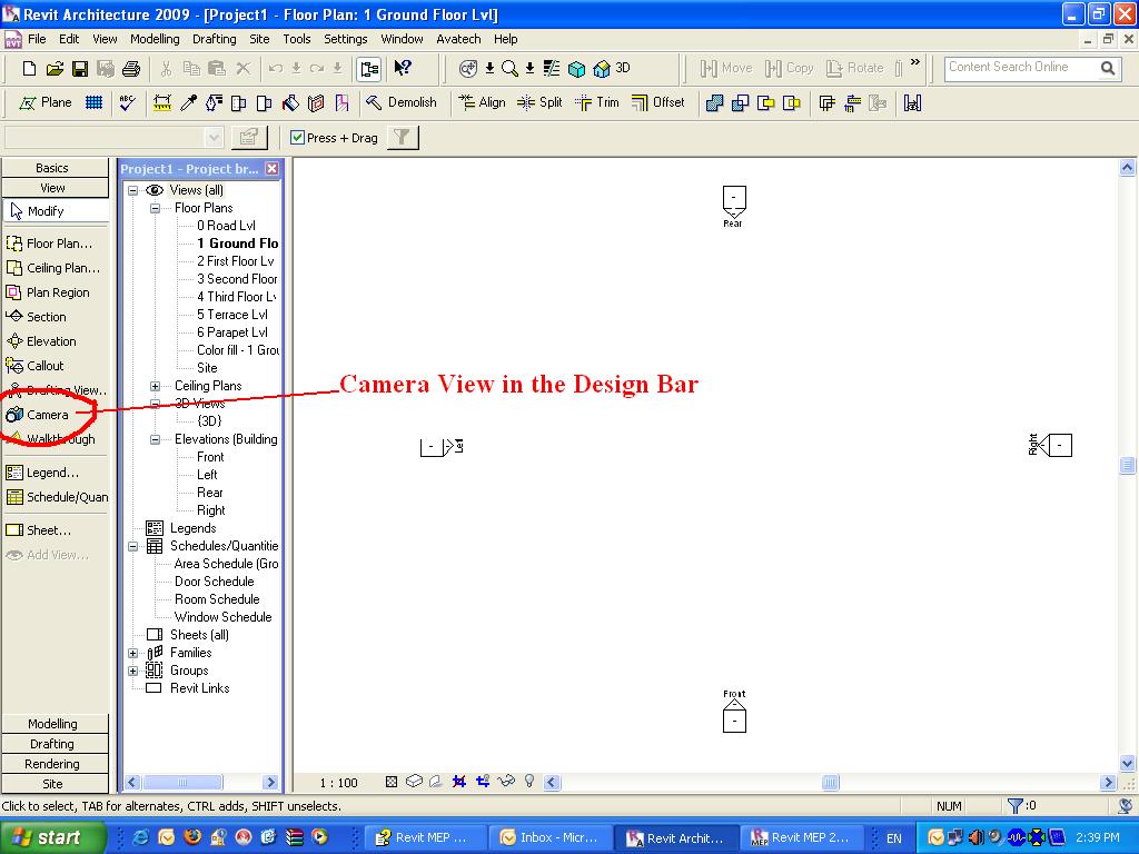

As I am working on Revit MEP 2009, I want to plot some sheets & one of the sheet includes a camera view, but as I go to View tab of Design Bar, I am not able to see the Camera option which is seen in Revit Architecture, Thanks in Advance

The camera tool is available but it's in the pull down menu only. Why ? Who knows. For some reason they have neglected to put the Camera button on the View design bar in MEP. You can just click from the top pull down menu > View > New > Camera. It would be wise to get familiar with all the pull down menus as there is more 'hidden' tools that don't show up on the Design Bar. I guess they did not expect the MEP people to be using the Camera tool as much as the Arch'l and Struct'l people?

thanx dg I got it, thanx for ur support.
