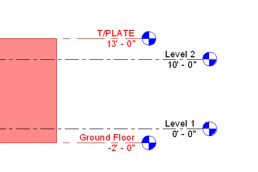

I'm not sure if you are using 'phasing' or 'scope boxes' which may effect this situation but I just ran a test (in 2009) importing an RAC model into and RST and the linked RAC levels came in ok. So in my new file I have the default Level 1 and Level 2 but the imported file has level 'Ground Floor' and level 'T/Plate'. My hunch would be 'scope boxes' are in play? See attached image. The link has been selected and high lighted.
