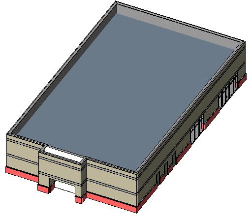

What is the process with the wall styles (old adt guy) to create projected framed canopies on a retail building for example, that miter back
to the main wall.
I have done this in adt for years with variable width chase walls, but I'm having a problem figuring this out in Revit.
I've been searching the web for examples but the closest I've found are brick cavity walls. Need brain dump on advanced wall methods.

This is the type of construction I'm trying to figure out how to do in revit. In adt I would have created a wall style that was then cut by an opening using a endcap profile for the jambs. The masonry openings in the photo are the locations of the storefront system. What is the right procedure to creating cavity framed wall types? And variable depth ones? I had to use individual revit wall types instead of say a 2 foot thick framed wall that could be used as in the photo. And sometimes in these designs, there is a buildout with an opening and no storefront only stucco.
At the base like in my posted revit jpg, there is a stone, or brick base that has to return back to the main wall.

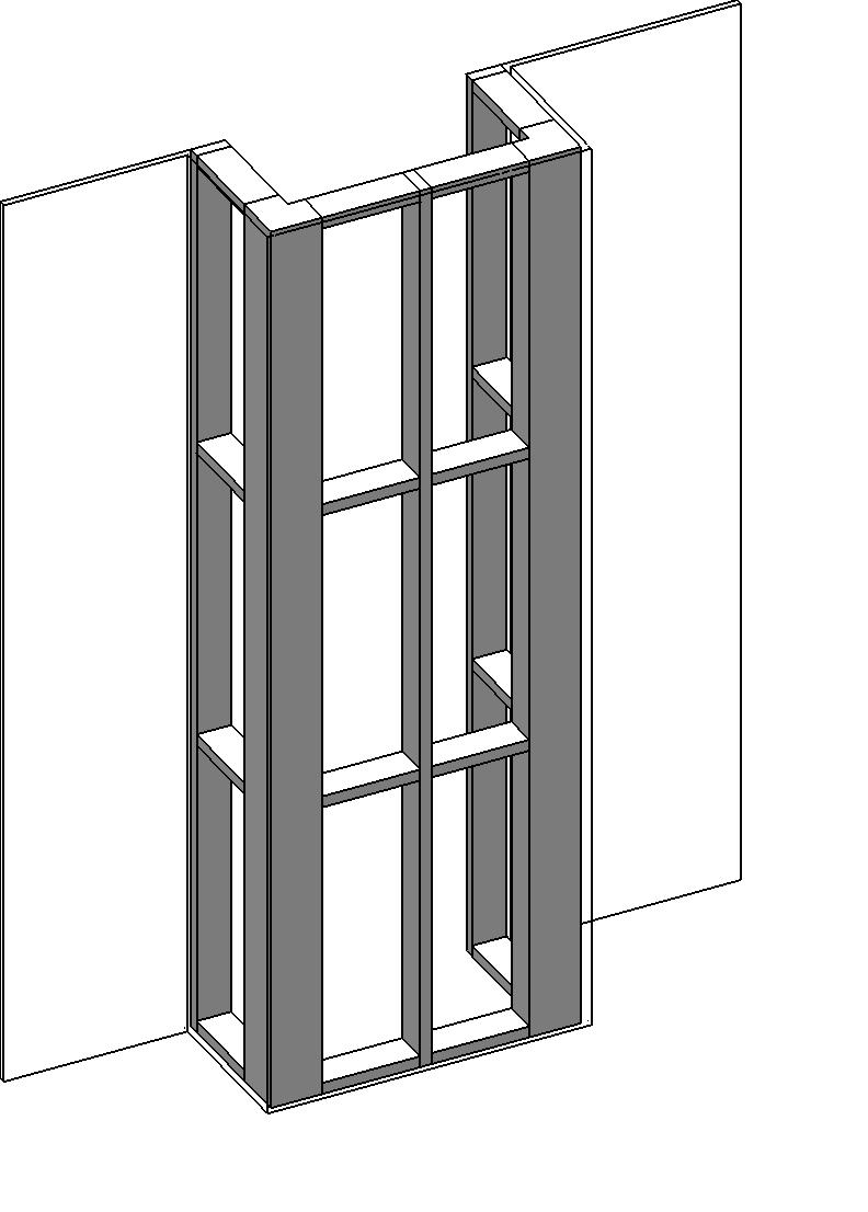

Hi, i think you must create that with structural columns, beams and braces and then you can put your "Wall" (2 foot thick framed wall) around the model.

Thanks for the great photo David. Nice inside look for junior designers to see.  I will fully and completely disagree with Mr. Typhoon. Specifically as a beginner, you would NEVER model every peice of steel around a building like that with structural columns, beams and braces any more than you would model each and every framing member in a revit model. Perhaps as your revit skills improve (to a much higher level) you may start to model more of the internal framing.
I would like to see a finished version of that facade but I would start with a basic inplace (massing) family and cover the internal framing with traditional 2d detaining. Once you get that process under your belt and repeat the exercise you may find better ways (and you will). Someone who does lots of this type of design drafting would have a Wall Catagory external family (.rfa) with parameters (easily done). You would simply place the facade family in the model and change the dimensions. Detailing still done in 2d. If you can post a finished version of this I can make you a video of how it's done.
Please forgive Mr. Typhoon for his incorrect answer as he has decided to impose on (and stalk) any conversation I have on this site and provide his worthless 2 cents. Which is fine by me because I will simply CRUSH him with my knowledge but it's not fair to mislead the other readers in his quest to annoy me. Moderators can you please get a grip on this guy.

I don't know who typoon is. Daryl I appreciate you repsonses. The photo I attached was the constructed structure. I am trying to document the symbolic ie: Plan and elevations delineated as typical architects do, the plan, refelected ceiling, sections and details as Revit is designed to facilitate.
What I have found out through Revit so far is that openings that should display as dashed above (soffits), have to be draw in using the line tool.
A wall that has a brick veneer with stud backup can't have a variable stud location ie depth of pilaster, cavity wall etc. off of the main wall structure and need individual styles to define multiple depths.
Doors, windows have to be created with the symbolic dashed lines above in the door style. And or the thresholds, sill also.
Is this correct? Or is there another work around.

Hey, if you dont need to schedule the structural elements, you could model the studs as a curtain wall. You can easily change the seperation distance of each element, and this way everything is linked as one. Typhoon and dgcad, can you please stop arguing. You both have good points, and you also have bad ones too. We are not perfect, and everyone makes mistakes. You need to be tolerant of other peoples views and opinions.

The Framing is not really my question. My question is (see attached autocad 2d drawings - non adt) how do I achieve this type of construction documentation in Revit for my floor plans and plan details and exterior elevations. The framing contractors can engineer the stud work. I'm trying to design the exterior skin of the buildings as I have done in the past using ADT, but with revit as a newbie. Which worked pretty well at this type of design.
1. So what are the approaches at managing the wall types to achieve this. Multiple variant wall types? Or can one wall be used for the main wall and another used for the brick veneer (build-outs) with it's core structure the same as the main wall?
2. Again I find that by adding an opening, that revit does not shows the sybolic dashed lines of that opening within a wall. Doors & windows are the same way. I have to draw the lines in myself.
I just want to define the wall types, create my floor plan and then be able to detail the plan details at the brick base level, above coping level and at the canopy level. I know that revit can do this, but the fewer wall type styles the better.
