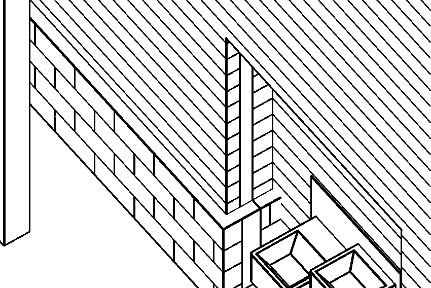

I have set my walls so that the exterior wraps at ends and isnerts.  The options are ext, int, both, none.  I have noticed that revit will only wrap HALFWAY if you say just interiro or exterior.  Does anyone know a way around this or if I am missing something.  One would think if I selected exterior, that I want the exterior material to wrap ALL THE WAY THE ENTIRE DEPTH OF THE WALL!!!  But that would make sense now wouldnt it.
I have attached a jpg of the corner in question.  As you can see, my exterior siding wraps only to the center of the wall.  That corner turn is actually 2 wall openings so that I can get the CMU base and the wall itself to turn at the DF.  Any ideas?  Thanks.

workaround:See attached image.
  1.  The red part of the image is actually a small wall mitered to  the long black brick wall. Just for the look of it but that doesn't work, construction wise.
