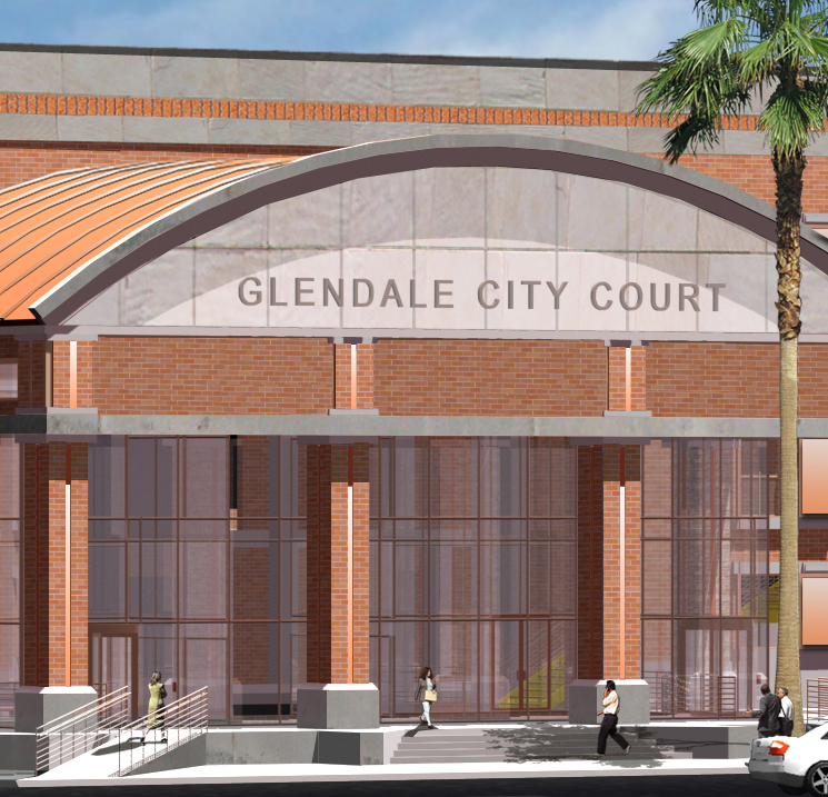

We are new to Revit, and we are working on getting a workflow together for rendering our models. Example, we just finished up project with three different models, we needed rendered, and with the short amount of time we had, we couldnt make Revit work for us, and ended up using 3DS Max and Photoshop on this. For future projects, what kind of time do we need, should we have a dedicated machine for rendering in the office, instead of using the machine we are doing the work on. Currently we are running quad core processors w/4GB or RAM Here is an example of what we are trying to get to, using Revit.

Hi, Revit is not (YET) multi-processor but if you have a 64bit system (XP or VISTA) you "take" all RAM from system, so, MAX is multi-processor, so, "He" spend less time to render then revit, you can use SMP SEESAWto isolate Revit in one Processor and take the others to work in others programs at the same time, the image you post, in Revit, i don't know but, it take in BEST quality, 2 hours (i Guess)....
