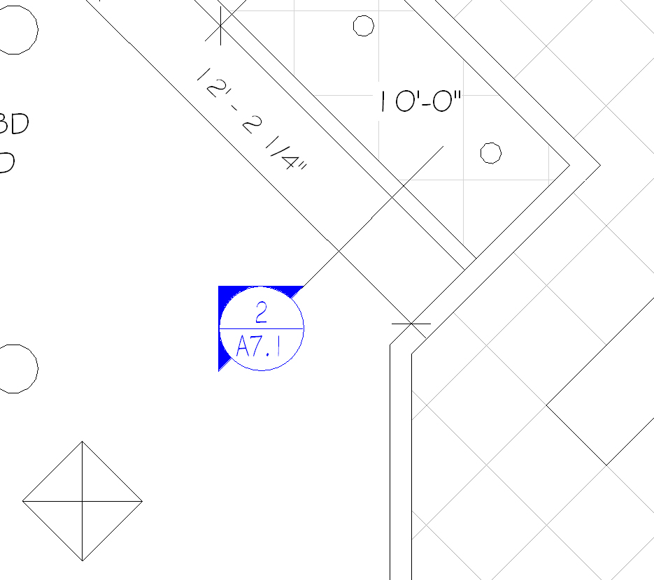

I need this section tag in more than just one place on these sheets. How do you do this AND keep it parametric. I don't want to draw it with lines and fills and make it a group.

Click on the section and on the top u get - REFERENCE OTHER VIEW.
Hope it will work for you.

THANKS IT WORKED
