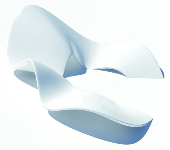

Ive modeled a flowing form in 3dsMax and exported it as a 3d DWG. After importing into Revit, is anyone aware of a way to cut the solid in section and plan?
Thx for the help guys.

here is an image of what ive done in 3dsMax for interest sake

Read your help on what is cutable.  The import is not.  You may be able to import it into a family that is.

yes i believ the best way is to import it into a mass family then import that
