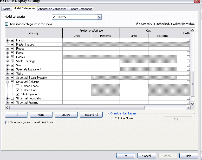

Hello,
I am trying to hide the "analytical model" blue dots and circles that display in my structural columns when I link them into other files. I do not have that option (see attached image) in my visibility graphics. What am I missing? I am using Revit 2009.

Everist, pick in bottom Where it says "Show categories from all disciplines" then appears in the "structural columns" the field "analytical model", then you can uncheck...
Edited on: Tue, Aug 19, 2008 at 4:42:08 PM
