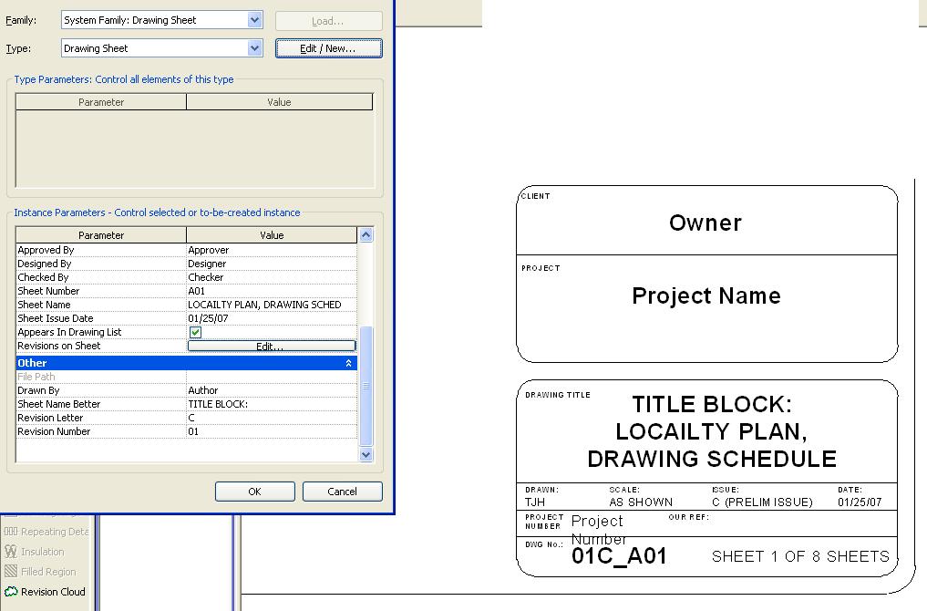

Hey, using RAC2009.
I have set up a shared parameter called "Sheet Name Better", and I managed to combine this in a label to the parameter "Sheet Name" (its already a default one in Revit). Sheet Name Better was created to enable me to have non-printable characters in my drawing name. Everything is working fine, however the drawing schedule causes me grief. Is there a way to combine my shared parameter and another parameter into one item? I want it to be in the drawing schedule Sheet Name, or Sheet Number.
In the title block where you can combine many labels into one, this is what I'm trying to achieve on my drawing list schedule.
Thanks in advance =)

Alpha-numeric string manipulation (formulas) is on the wish list being voted on at the AUGI site.
