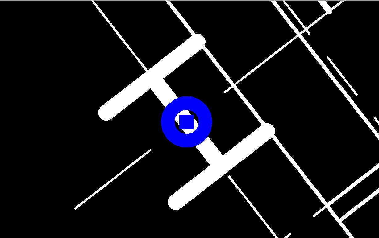

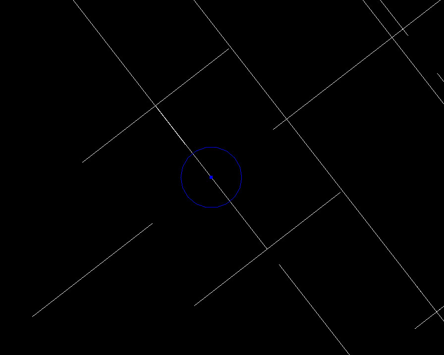

How do I hide the blue circle at the colun axis in Revit Architecture 2009?  Autodesk says it is an analytical model symbol from structural, but structural says they have no analytical model and suggested to check our VG and turn off analytical, but no analytical heading is listing.  Please view image and advise.

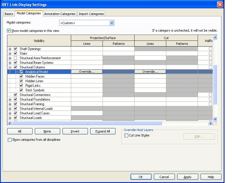

This is the analytical line associated with the column family.  You can turn it off in your model using the "Visibility/Graphic Overrides":
Select the "Revit Links" tab,
Highlight the liked file and select the "host view" button.
Next check the custom box on the basics tab then select the "model categories" use the pulldown to select "custom" Scroll down to "structural columns" expand and uncheck the "analytical model".
Unfortunately this has to be done in each view but it can be handled more effectively using view templates.
The final step is to respond to your structural team and make sure they are aware they are simultaneously building the analytical model whether they are using it or not Winking.

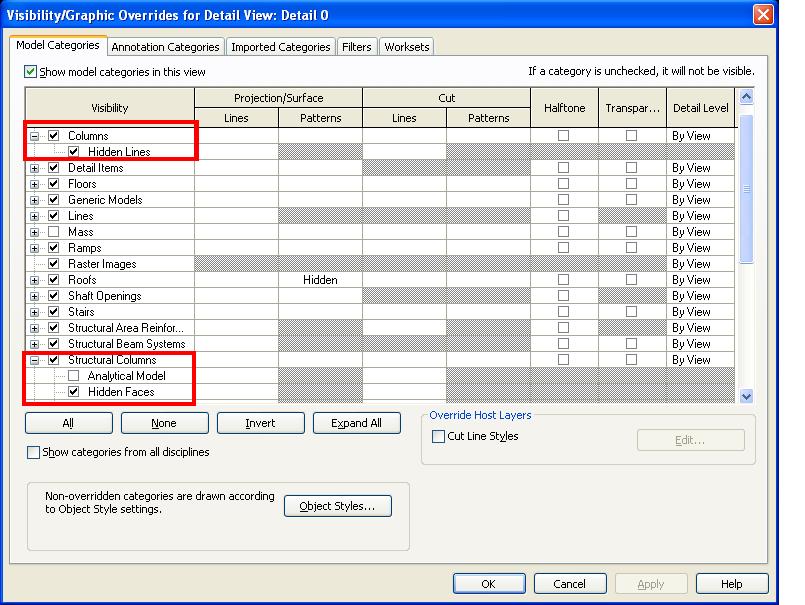

Within Revit Structure I have the ability to turn off the analytical model for the linked view in my "visibilty graphic overrides" by expanding the structural column tab.  My assumption is that Revit building does not list structural columns in the "visibility graphic each views "visibility graphic overrides", using the procedure listed in the previous post.  I have applied this method to the linked File A within File B.
If you are using Revit building you may need to select the "show categories from all disciplines" on the "model categories" tab of the "RVT Link Display Settings" in order to expand the structural columns to turn off the analytical model.
